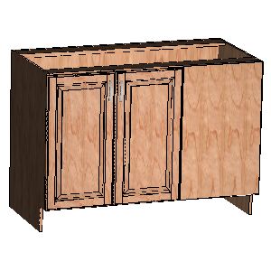

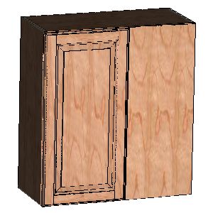

In the past you would be able to add two different size doors for the same cabinet in the door and drawer editor.
You may ask why. I used this feature to create blind corner cabinets.
For instance I would add the left door what ever it may be as far as style and size which would be the working door, I
would increase the offset on the right side to leave a opening for the overlay. Then I would add the right door as a
slab door in the material that the cabinet exterior was finished in and set the offset for the right side to accomidate my
working door. I would change a few of the offsets so that it was a true overlay.
Now when I try to do this the software only allows me to add one door and would leave the opening where I would add
the overlay. It does not allow me to add a second door. I did not notice this as I have standard blind corner cabinets
but I had to change one this morning and that is when I noticed the issue.
When I try to open these cabinets for editing eCab crashes.
If I place a partition in there it would mess up my adjustable shelf.
Can something be done about this?
thanks in advance.
Steve

Scott G Vaal
Re: Door Drawer Editor
Post by Scott G Vaal »
Steve,
Each of the attached cabinets have partitions in them and all seems to work fine for me. To the best of my knowledge, eCabSys has never allowed you to add more than 1 door side by side in a single opening (other than a double door). Do you have some older versions you can attach that you believe had the added doors without the partition divider? Are these the cabinets that crash for you?
