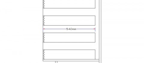

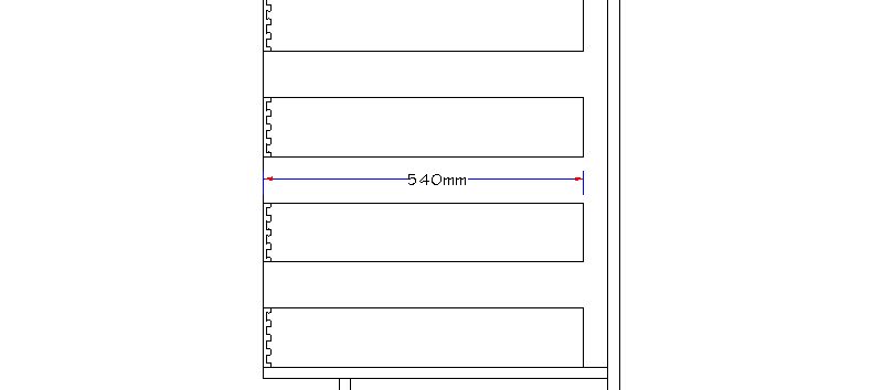

Any ideas for me our slides require 540, 490, 440 lengths. With our regular drawers I set the depth increment to 50mm and designing the drawer I did a 10mm back inset so it automatically adjusts with depth change. We are using the dovetails some, on these I can't seem to do a back inset. Is there any other way to trick it?

Hey Sheldon, if you add the 10mm inset to the sides, bottom, and back you should be able to get the results that you're after.
