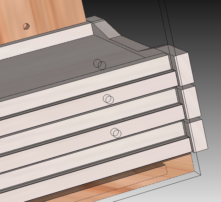

I can't find any reference on the forum to the "Add Slot Slide", can anyone tell me what the hole is for on top or how to eliminate it? Please see attachment.

Hey Sheldon, check for a hole pattern associated to the drawer box.

Thanks Rick, but as far as I can tell there is none applied. Here is the file if someone wants to play with it. It is as if they expect a guide or something to be put in there.

Try rebuilding the drawer using a generic box. The holes are associated to the existing box.
