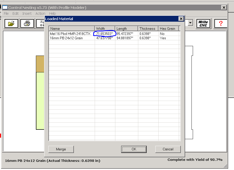

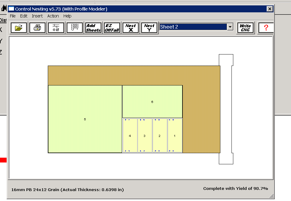

Perhaps it's your material size? Nested okay for me other than the sheet being bigger than my table.

Thanks Daniel. This gets stranger. Just went to nest another job with draws in it. Throws up the same error. This time it is just standard white board. However if I turn off the 6 separate draw slabs in the job and turn on 1 draw slab and make 6 of them it nests fine. I see you are running the same CN as me. it has got me stuffed.

If you are running in metric, grouped doors will cause this error in version 5.73 of Control Nesting.
