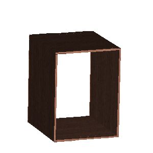

The programs seems pretty stable in windows 8, and I cant be bothered having to down grade then upgrade to be honest. For us I NEED the constraints to work properly as we are using to build roadcases for the proaudio industry and setting a "case template" with the constraints in place so I can resize the case as needed for the customer and all geometry to stay the same, the problem im having with the attached file is if I resize it in the main editor the left and right panels change but the panels with the holes stay the original size, however if I use the test function in the constraints manager its changes as expected.???????? Would be nice if this worked as expected.
As for the contours editor and the patterns i've found that if i shutdown the program restart it and redo the exact same steps as when I have had a problem trying to pocket the pattern then it will work. Another weird one. had the same problem in windows 7 with this.
8U Shockmount Rack Insert With Rackstrip Holes.jpg (6.96 KiB) Viewed 10662 times

Well you could create a windows xp or windows 7 virtual machine and run via vmware, might work, haven't tested it but I run Autocad 2011 that way just fine, maybe I'll try it out if I get some free time. Are you trying to load an x_t file or dxf? If dxf, you might want to look at the file type you're saving it as. Can't tell much from your jpg, try posting the hsf and the pattern/dxf in question. Post your computer specs as well. A couple of constraints shouldn't be an issue, but if you're setting up some really complex constraints then you might need to use something like Inventor instead, ecabinets just doesn't seem to be designed for that type of work; though you can accomplish a lot if you're willing to put in a lot of time and aren't easily frustrated.

You only sent attached a jpg of the box. For someone to assist with this you need to attach the .hsf file for the cabinet.
