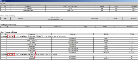

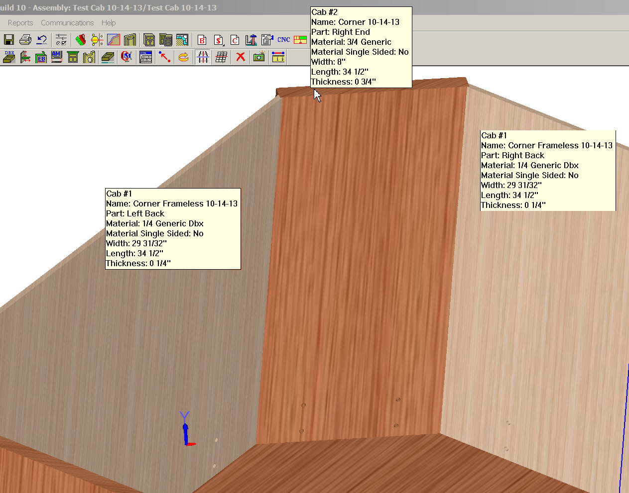

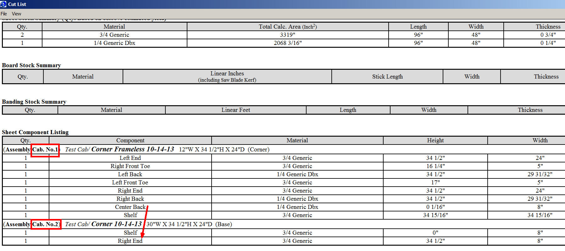

Does anyone have a cabinet design or can I change the cliped back of the cabinet to 3/4" material while leaving the other two backs 1/4"? I would like to make the cliped part like an end with shelf holes and dados.
Thank You
Re: cliped corner cabinet
Hi Alan
There is the way I would make a clipped corner cabinet
I would make it out of 2-cabinet
Test Cab 10-14-13.esa
