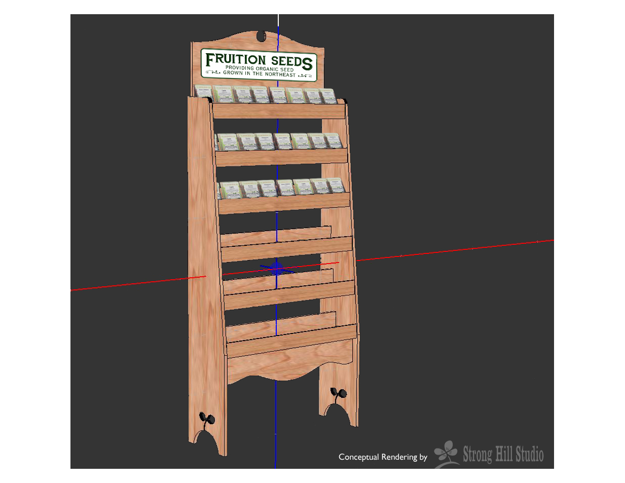

I've included a JPeg that shows some simple elements that were part edited for a simple seed stand were building. As you can see, there's some simple pocket cuts in the sides of the display. A little seed sprout that is usually between the 'Fruition Seeds' type on their logotype. To simplify and keep costs within budget we removed the seed pod from the graphics and used it elsewhere. All done in AI. The placard will be getting CAM'ed out in another package but the rest of the cabinet will be handles by good ol' e-cabs. The image was composited using Photoshop (another Adobe standard product).
