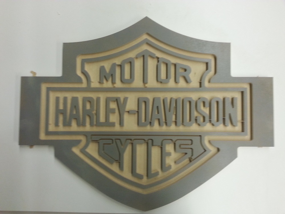

Just touching on DXF files with our Thermwood 43. I've attached a pic. As you can see, some areas were not pocketed? Not sure if my settings for tools are correct. It used 1/2", 3/8", 1/4" and 1/8 tools to create. We have just purchased Artcam but haven't had time to use it yet. Any ideas about why these random areas would not be cleared? Also a few of the letters have been cut wrong?
Any tricks or tips are appreciated
Ian

Will... the link you refereed to is not really discussing the same issue with Layered DXFs (the link is discussing linearization of polylines and data from external sources)...
The issue that Ian is having is due to the fact that Control Nesting does not support pockets with islands (that's when you want to leave areas within a pocketed area alone). It appears that Ian has tried to work around this by creating multiple pocketed areas that butt up against one another in order to avoid certain "islands" when clearing out around them. The problem with that is that you can't overlap the regions so you are then left with "corner radius" artifacts.
I am not sure why some areas did not get pocketed in Ian's image - I would have to look at the DXF itself.
I think that most people would state that Control Nesting - and what it can do with simple Layered DXF files - is great. I also believe that some people have done AMAZING things manipulating the tools available in the DXF/Control Nesting feature set.
I would also like to point out that - and I hope that I am not out of line on this - what Control Nesting does with Part Editor operations, Profile Modeler and via Layered DXF files was never intended to do EVERYTHING a full CAD/CAM package can do. It can do some things they can do and even some things they CAN'T do, but it is not able to do everything a whateverCAM can do. Perhaps one day, but for now the more complex tasks or areas where one wants more specific control over the machining parameters may require a 3rd party CAD/CAM program. Luckily a Thermwood can work with the majority of them.
