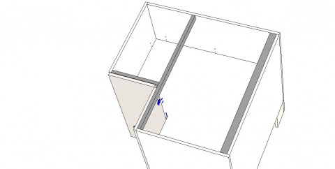

I'm looking for a way to put shelf holes into my cabinet's back for when they are wide for extra shelf support.. I'm not sure if this is possible yet..
Also it would be great if the depth of the holes can be set seperately to avoid an extra flip part!

Re: Shelf Holes in Back
Hi Stephane
yes it can be done.
you have to take the parts into the part editor.
you can make up templates in the contour section and save them.
As long as you set up your hole spacings to a standard you can use the same template.
I have attached a corner cupboard where I have put in the extra holes (not tested).
It would be a nice feature to have added to eCabs, a bit similar to the hinge spacing setting.
CNR 885x885LHDd.hsf
Corner cab with adj holes in back.
(844.02 KiB) Downloaded 569 times
