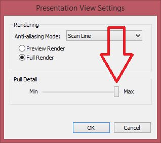

We have discovered an issue with the Pull Detail option in the presentation view causing a crash situation. Please try the following and see if it takes care of your situation as well. Go to the Render View area, then select the Presentation Settings button on the left. Set the Pull Detail slider all the way to the Max position, then select OK. Now, perform the presentation view and see if it will complete successfully, then let us know your results.
Pull Detail1.jpg (13.92 KiB) Viewed 27058 times

Scott G Vaal wrote:Gene,
Scott,
That seems to have fixed it. I just took the job I had emailed into presentation view, and it worked fine. I will be working with other jobs over the weekend and the first of next week, if I run into similar problems, I'll let you know. Thanks.
