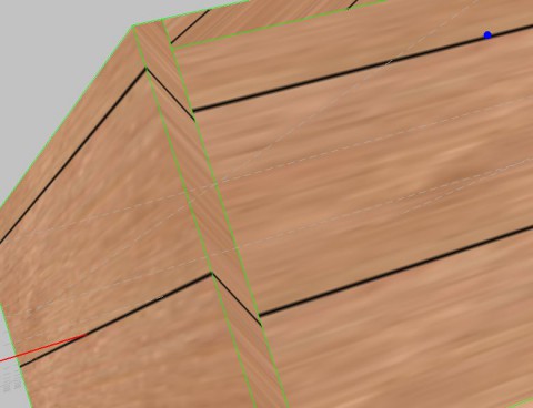

Also, my renderings all seem to look like the sheet stock is actually made up of board stock - i.e. they appear to be slats joined at an odd angle. It seems to do this no matter what material I assign. Is there a simple setting I'm missing? I've attached an image showing what I mean.

Ron,Ron Sloan wrote: Also, my renderings all seem to look like the sheet stock is actually made up of board stock - i.e. they appear to be slats joined at an odd angle. It seems to do this no matter what material I assign. Is there a simple setting I'm missing? I've attached an image showing what I mean.

Does the same look happen if you load one of the cabinets from the Standard Cabinets directory?

Scott - yes, cabinets loaded directly from the standard library also exhibit this look.

Would you please save a cabinet with one or more of your own materials/texture images and post it here. I will load it on my system and see if I get the same result. Thanks.

The same phenomenon appears in virtually all the editor. Attached is a Std Base Frameless Cabinet, with default generic 3/4" sheet, and I changed the top material image. Hope this helps.

We cannot reproduce this issue here. What graphics card do you have in your PC? Please ensure you have the newest available driver installed for it.

I have a Radeon X800 series card, with the latest available drivers for Windows 7 Ultimate. If I'm correct, it seems to have started after I installed the materials library. I just tried changing the material color for Generic 3/4" material to sr-wood f-c White Birch. While it looks better, you can still see the same thing happening. Looking closely at the endgrain on the side panel, the garin appears to be slanted at ~45 degree angle. With this material, at least the grooves don't show up. Don't know if any of this info helps, but thought it couldn't hurt!
Edit: digging a little deeper, it seems the grooves show on almost any material, except those in the Formica, Stone, Marble and SR-Wood categories. Those materials look fine, except for the angled end grain as shown, which is not a big deal.
