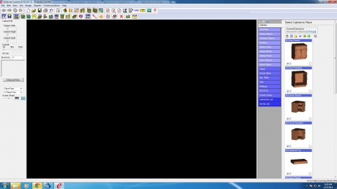

I just upgraded my computer from Win XP to Win 7 and loaded Build 14 on it. Every editor comes up as a black screen as shown in the screen shot.
I uninstalled and reinstalled 14 and I get the same results. Has anyone else experienced this??
Thanks, John

What graphics card is in your system?

Intel R graphics media accelerator HD

First, ensure that you have the latest drivers available for the card installed. If after that you still have this issue, go to Setting/Preferences (in eCabSys) and check on the option Use Graphics Double Buffering. You will have to restart eCabSys to fully implement this setting. Let us know your results.

updated driver and it works :D should have thought of this sooner.
