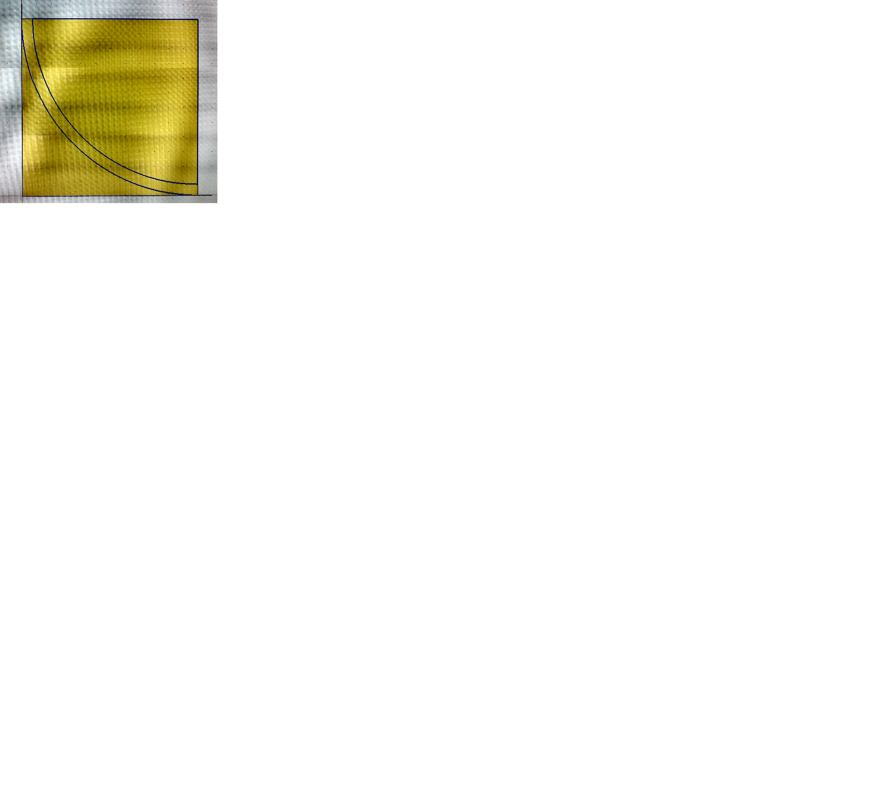

I've attached a screen shot of what I am trying to do. Basically, with the fillets set and the cube outlined, I'm supposed to be able to cut away the geometry of the two supposedly closed radii. As indicated in my original post, the software is telling me sometimes that the radii are open or that the ends need to trimmed (something I tried that also didn't help). Occasionally, it has allowed me to cut the right hand radius but not always. Help, please!

You probably have duplicate entities right click under delete select duplicate entities. Then trim again and see if this works.

Hi David. I think that I have reproduced your situation as I suspected there are probably duplicate entities causing this error. Here is a video on what I came up with on why it is happening and how to fix it. I hope it helps.

I see the issues described here and displayed in Scott's video. The first and main issue is that it still sees 3 entities after creating the 3" radius fillet between the two 3" lines (note that in the lower right it still says Entities= 3). When you fillet an entity to nothing, such as this case, it should be removed from existence. The fact that they still exist (but not really) is the root of the issues here. I will get this listed and resolved for the next version. Thank you both for the info on the issue and sorry for the inconvenience.
