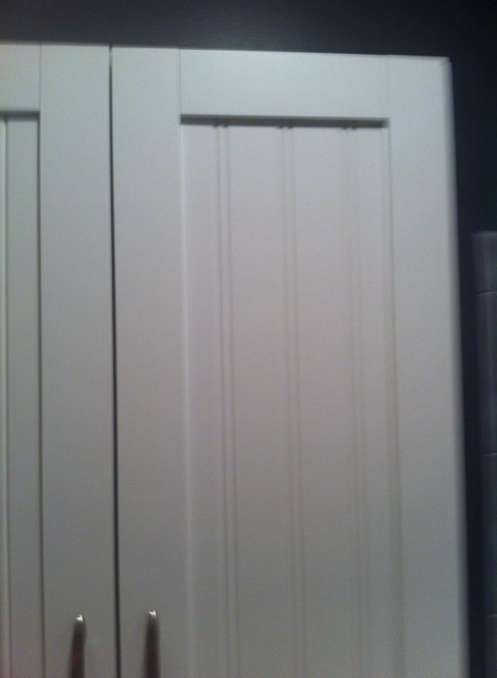

Hi guys,
This may be a dumb question, but is there a way to make this door in my drawings?
Thanks in advance for any and all help.
Rick

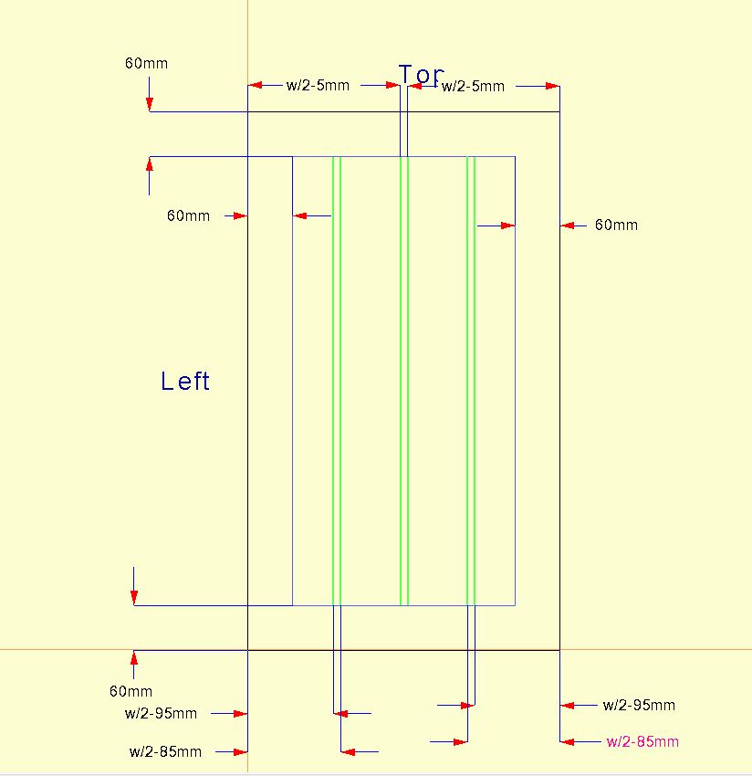

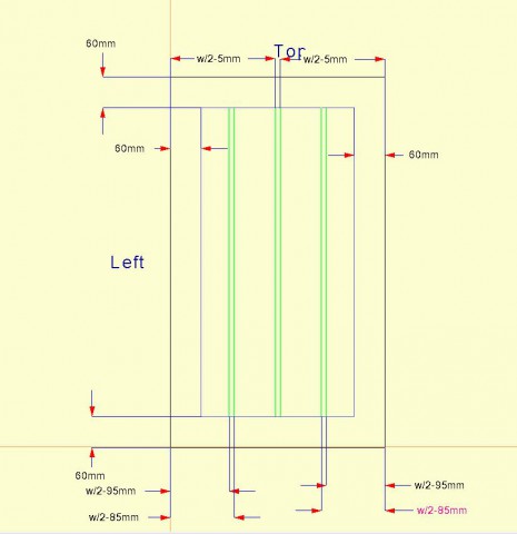

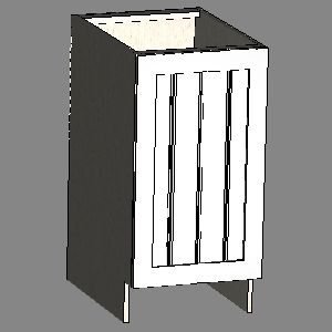

Re: Beaded panels in doors.
Hi Rick
Here is one I did in the part editor and constraint manager.
It would be laborious to do all your drawers and doors because you have to set up every door and drawer for each unit that increases every 50 mm.
It is resizable up to about 50 mm increments
So 300mm unit to 350mm, 350 to 400, 400 to 450 an so on. 2 door units and corner doors and drawers all need individual attention but you get quicker with practice :)
I suppose once you have set your library you can just pull the one you need.
Hey Neville. Perhaps you could test it out for me and see if it works.
Put your hinges on it and add a handle and see how it goes :)
I Used the Amana AMA-56102-noBEARING.tol set to a -12mm depth.
In eCabs it looks okay but I think it may leave a divot in the top and bottom rail when machined.
I was trying to make a cutter in the shape manager with a closer profile but for the life of me I couldn't, I tried various shaped cutters more in line with the profile and tried to save as a .tol file, couldn't do it.
I used 1,2,3,4mm configurations extending every line and trimming, no cigar.
Guess I have to go back to the training vids for a refresher :(
