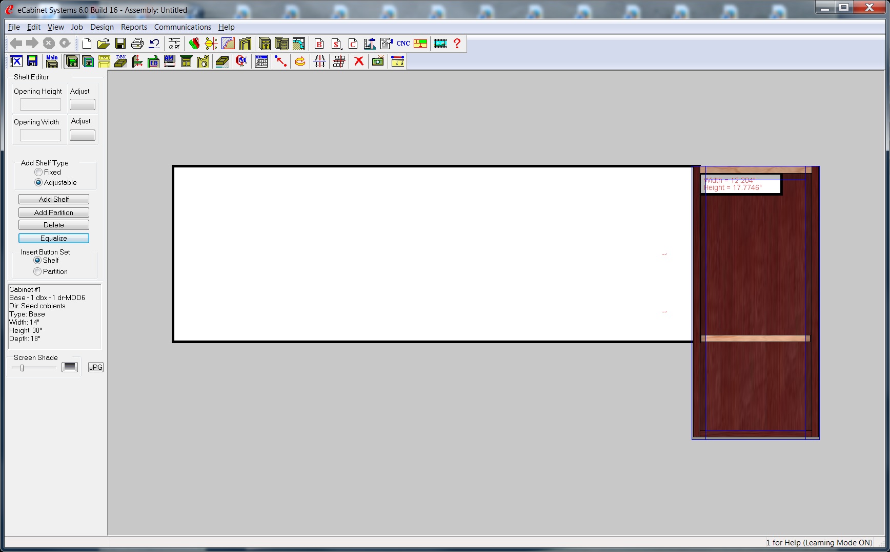

I am trying to edit the attached cabinet and get the following weird screen displays. Yes, my video drivers are up to date as per the manufacturer of my video card.
It's acting like there is some kind of phantom, invisible part to the cabinet causing these display.

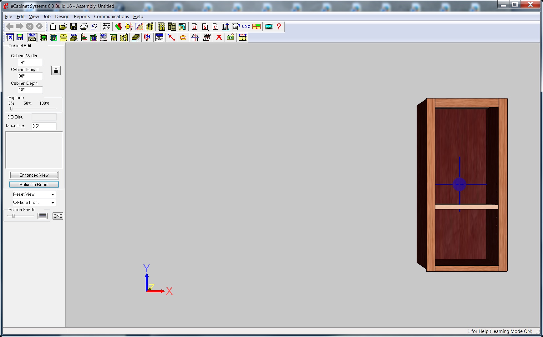

Don, I loaded the cabinet and I think the file is corrupt. It shows the opening height for your adjustable shelf
is (negative) -19 7/16
and I can not delete the shelf. I did nest the cabinet and all looks ok
Strange problem you have here. Hope its just this one cabinet.
Tim
Tim

Yes, I had just resized the cabinet using the context menu to resize. Then took it into cab editor and that's where the strange things started happening.
It is the only cabinet in a job with about 30 cabinets that did this. This one was created from the same seed cabinet that was used to create many of the other cabinets in this job. This issue didn't come up for air with any of the other cabinets.
I guess it's one of those hidden software gremlins that comes up for air once in awhile....
