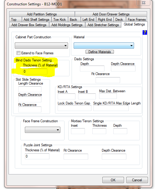

Would it not automatically set different depths when you select % of material for blind dados?

Tim, that will only effect how thick the dado is not the length.

Ok, but it sounded so good in my head - maybe that could be a fix ?

I believe that is only for blind dados I am doing full Dados.

I think that Tim may actually be suggesting the possibility of a future release of having a percentage setting for the tongue length (aka dado depth) be based on the thickness of the receiving dado's material.

Yep! I thought it sounded good in my headBrad McIntosh wrote:Forrest,
