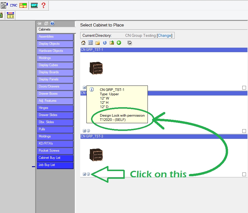

Scott G Vaal
Re: Design Lock
Post by Scott G Vaal »
Jeremy Schiffer wrote:One more question: How can I tell which files or directories are locked and which are not?
Jeremy,
You can see if a file is Design Locked by clicking on the info icon below the cabinet or assembly in the Item Window.
