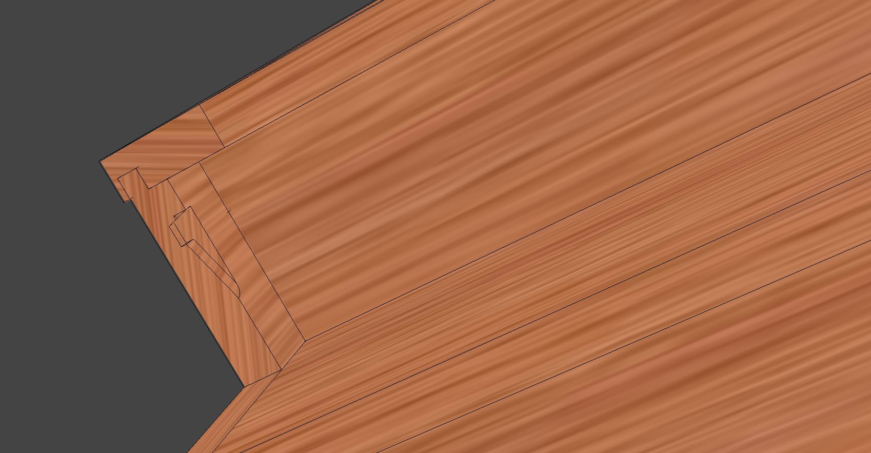

Allow to use the pocket hole feature with blind and full dadoes. We dado our face frames into our ends. If I use the lock dado w/Pocket Screw I cannot set the top and bottom insets to 0 and offset the pocket screw also. If I set the top and bottom inset to say 3 inches then the ends will be notched out by this amount, leaving a void. I know that this would be no problem for the base cabinets or the tops of the uppers but the bottoms would not go over well. In the mage below I have the top and bottom inset set to 0 inches.

Ok so I did not upload the image. Here it is
