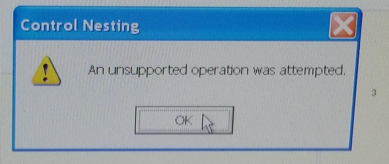

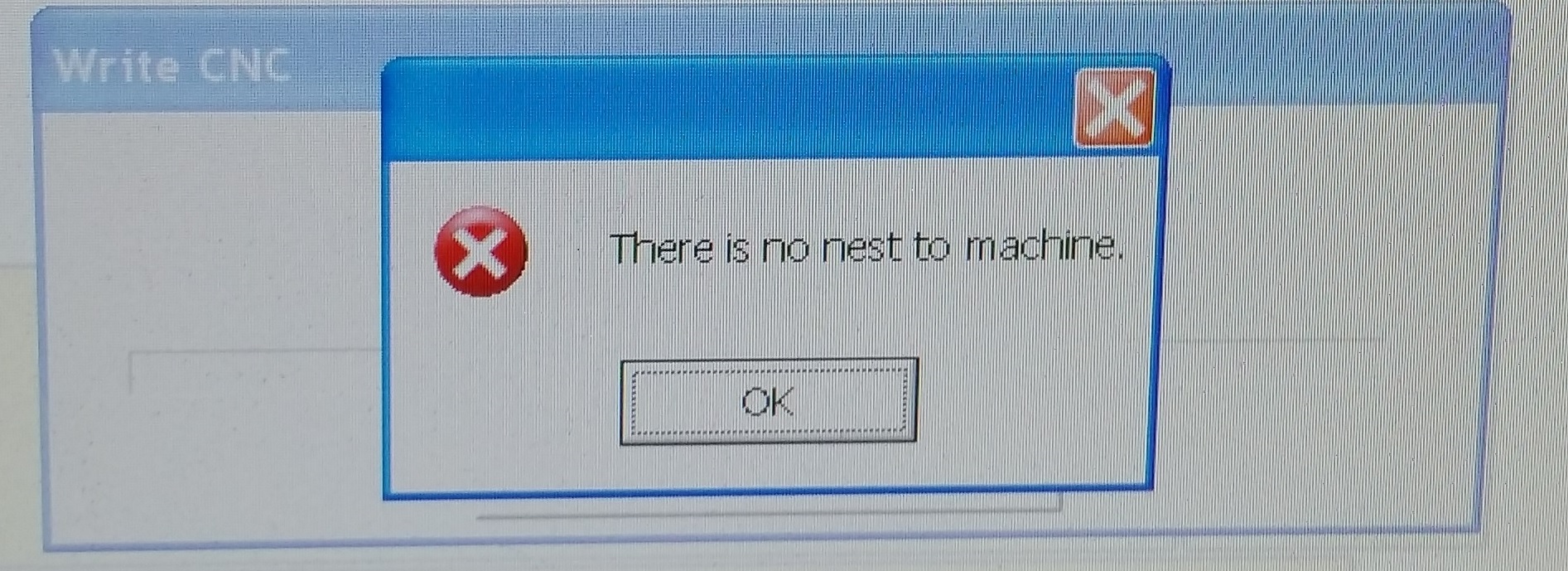

yesterday we had a new error come up when we tried to nest our aquaban material up. we could nest the material and add sheets etc but when we try to write cnc it comes up with the errors as shown in the pictures attached
this is the first error that pops up
this error pops up shortly after the first
has anyone experienced this error or know of any fixes? we looked at the tooling settings for the material but all is ok.

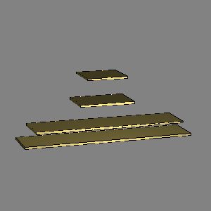

hi brad, the file was sent from ecabinets using twd file format. where are running the latest control nesting version 5.85, i have attached the file that we found this error on first. its only this material thats doing this any other material nests ok and performs like normal
thanks
chris
rosman tops.jpg (7.21 KiB) Viewed 24332 times
rosman tops.esa
(632.02 KiB) Downloaded 1566 times

Hi Chris. Verify you do not have 'No Outline Cuts' checked for the group setting of that material. The next version of Control Nesting will give a more appropriate error message for this occurrence.

hi larry, the settings are still as they were originally, i can nest and cut our melamine material perfectly its just this material.. i have changed the name of the material that we are trying to cut and it has solved the issue. i dont understand why that has made a difference as i also added the new name for the material in the tooling setup. to me it seems like a small glitch with either the control nesting or how ecabinets is saving the twd file
