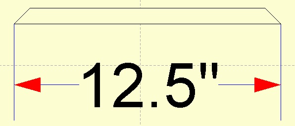

New to using ecabinets shape manager. I have made a 12.5 wide piece, but it cuts at rite around 12.1875 not the 12.5 its supposed to be. I set the depth of the bit to -.75 and mic'd the material at .78 I have included the tool file I made and the assembly. any help would be great.

I was just looking back thru my post and noticed this one and figured I post again.
If I remember correctly............
I fixed this error in the profile modeler, by changing the bit from spherical to straight.
