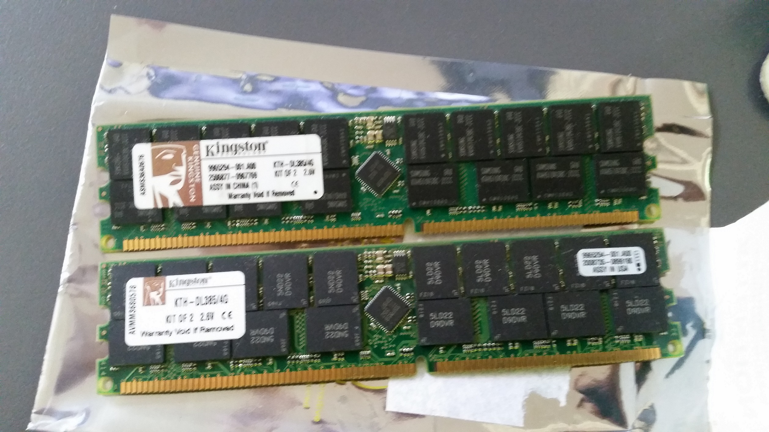

[i have installed new ram they are 2 sticks of 2gb, but on startup makes a continuous beep and does not boot up. which means either the ram is faulty or the mother board doesnt support 2gb sticks
do you guys know if this is the case or?

Will Williamson
Posts: 452
Location: Capac MI
Re: Cnc is loading jobs slow and slow in general
Post by Will Williamson »
You have to replace it with the same style that the machine came with. I called thermwood to find what was in mine originally.
Mine was DDR400 consisting of 4 (1) gig sticks
Will

Chris Armstrong
Posts: 69
Joined: Tue, May 19 2015, 7:44PM
Country: AUSTRALIA
Post by Chris Armstrong »
yeah i read the ram and ours is DDR400 too, but the motherboard must not support 2gb ram sticks, thanks for your help will see what i can find in 1 gig
