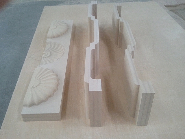

I finally had a chance to cut the drawer fronts for the mdf prototype. So far it is working nice.

I was playing with the sliding dovetail but I never got it implemented. The Feet were another part I didn't have the machining down for but most of the other parts are ready to go. I was able to do the dovetails on the drawer boxes but would have to hand cut the mating parts on the drawer fronts.
My prototype parts that I show got some melamine stacked on them in the shop which broke all the drawer fronts so it ended up in the dumpster.
