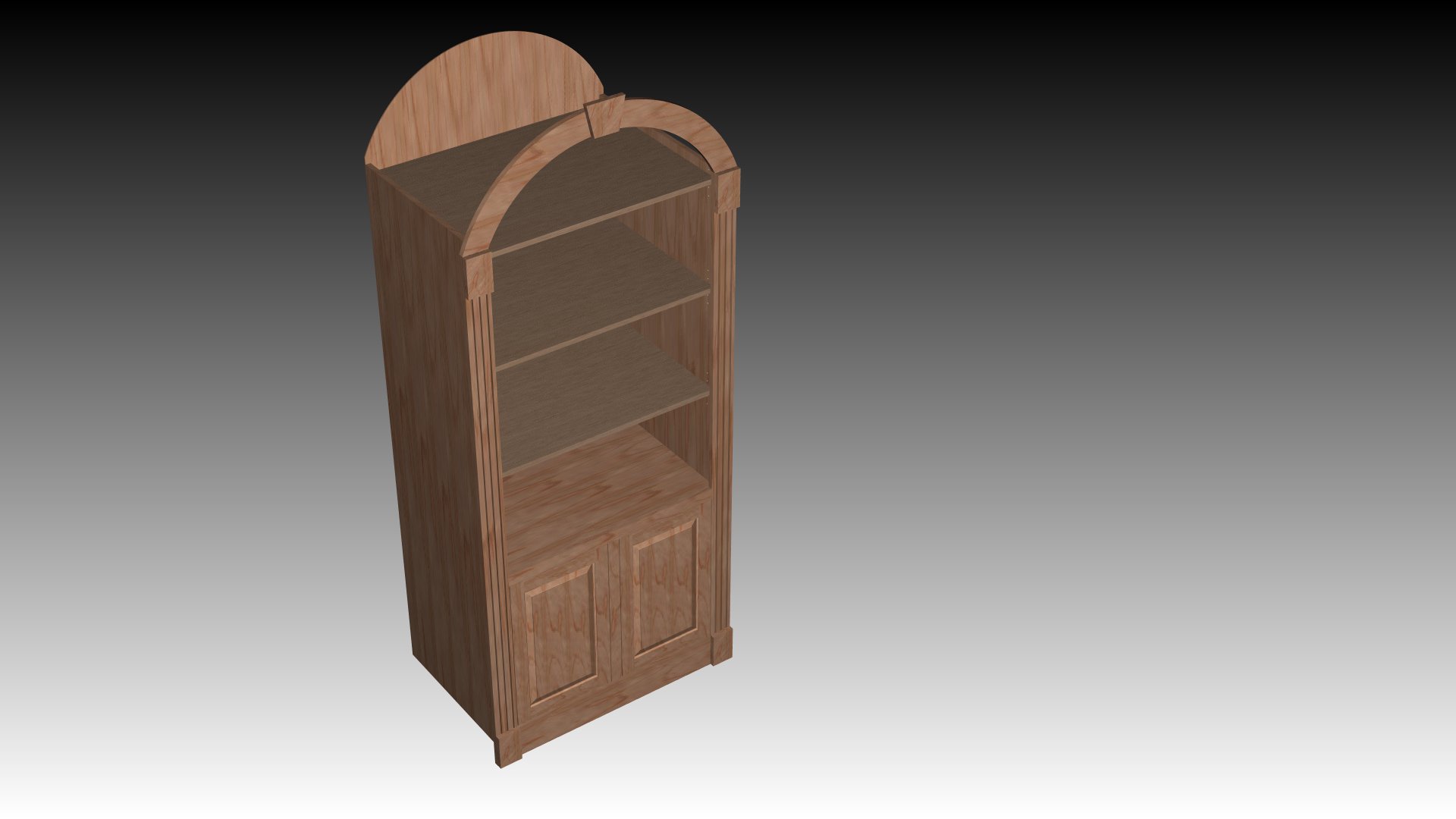

Spent some time one afternoon designing this cabinet so it would all cut on the router then the customer decided to go with a square top. I thought I would get some good out of the effort here.

I learned quite a bit on this. I was able to get things like the dadoes on the ribs that form the Timberflex for the top so they would slide in after the cabinet was built.
This will make the process easier next time.
We are also using the puzzle joint for face frame parts that is machined while the flutes etc. are being cut. The puzzle joint works great.
