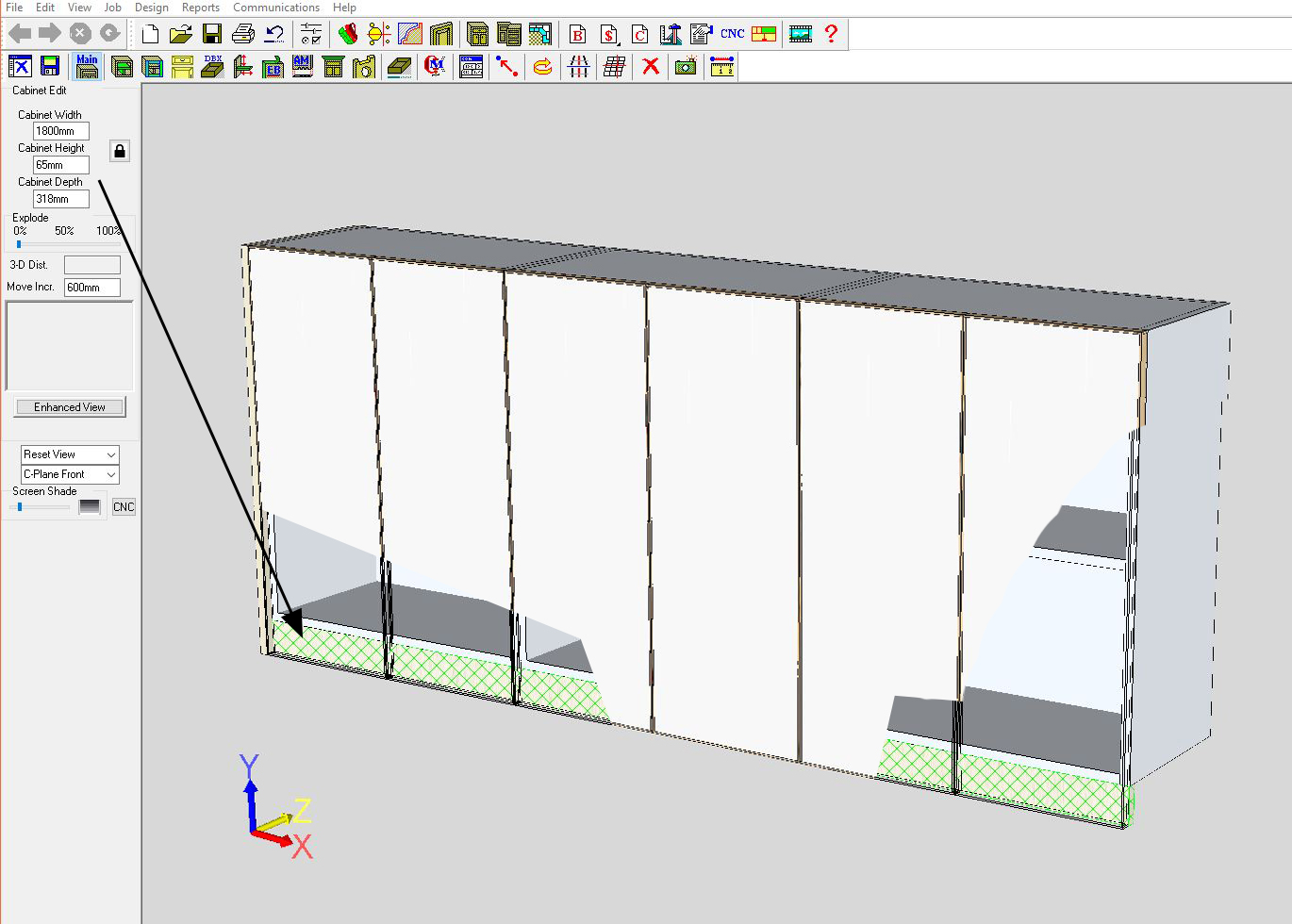

haven't used this forum in a long time. I do commercial cabinets and we use a lot of plastic laminates, PVC edgebanding and wood veneers. I'm using this software more frequently now but there are a few things where I am running into a snag.
1. how do I create a light valance on the bottom of an upper cabinet? runs full length of three uppers. 65mm high from bottom edge of bottom of cabinet. the door but cover the valance.
Use the molding editor where you apply crown molding to a cabinet - set your base molding to a light rail molding and apply
pay attn. to the distance box as it defaults to 0" on top
