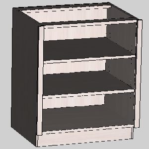

This may work for you. you may have to change the materials, but essentially it's just a matter of deleting top & bottom rail and applying your outside scribe to 11/16
single stile base Base Framed.hsf
(506.02 KiB) Downloaded 1654 times
single stile base Base Framed.jpg (15.94 KiB) Viewed 14167 times
