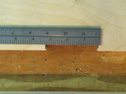

Getting some odd cutting results from an Ecab file. I'm cutting some 'stud' walls for a stage project. There are 4 up/down, left and right stretchers that get a full dado on their left and right sides. The 'mortises' are getting cut apx. 1/4" too wide. I've checked the construction settings but all looks correct. I can't find anything wrong with the cabinet construction settings but thought a fresh eye may help. I've also included the result off the table of one of the studs showing the mortice is way to large in the up down dimension. It should be 3". Photo shows it being almost 1/4" over wide!
I'm at a stanstill on this cutting job untill I get this figured out. Luckily I've only cut one stud so far. ANy help would be appreciated.

That is by design. Control Nesting will automatically overshoot full dados by the radius of the tool that is machining them so that the mating part will fit. If you don't, the part will not lay flat or fit in from the end because the radius corners would prevent it (in other words, you cannot put a square outside corner into a radius inside corner and have it fit). If you do not want this overshooting, you will have to remove the full dado and inset the stretchers the thickness of the material and then use part editor cuts like you've done on the center piece. I'm gonna guess that you have a 1/4" tool being used for this operation.

Of course! I must have gotten lost looking at it too much (or not thinking about it enough?). Yep, 1/4" MC bi. Picking up the extra width on the dado mortise length to clear the inside radius for a blind tennon's shoulder cut makes sense. Same rule applies to the full dado. DOOH! Welp, looks like I'm going to log in time in the parts editor some more.

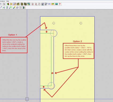

I have been doing CNC for a long time now and over those years I have found two fairly simple ways to get the inside corners cleared using just the outline tool (allowing a square part to fit all the way into the corner(s)). This method uses geometry in the Contour area and then cutting it through the part or creating the entire outline and using create part using closed contour. This is not necessarily just for eCabinets, it can be used in really any cad/cam application and can be used when creating DXFs for loading into Control Nesting as well. If you view the attached picture, you will see 2 options. Option 1 is probably the the simplest to create, but takes more material away. Option 2 is my favorite and take the least material away as possible and still use the outline tool. I add the extra .002" so that no matter if the tool is at nominal diameter, slightly over (which hardly ever happens), or any size smaller, it will always be able to get all the way in to clear the corner. The .7071 value used in option 2 is just taking the sin of 45 degrees to get the distance that the 2 directions have to move to get the radius meeting right at the 90 degree corner. The tool path when doing the outline will just dip the tool into the corner and continue on in a nice flowing manner with either option. Hope this helps and makes sense.
Re: Way to large mortices
Scott,
Yes it does. I have done exactly as you described in other applications in the past. Works well. I'll also get the shaper set up with a radius cutter, set the power feed up and dump the pieces thru. Sometimes it's quicker to do a secondary operation on another machine for speed. Either way I'm slowing myself down today with my brain fart in Ecabs.

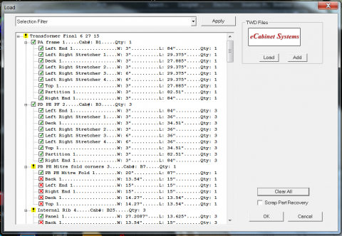

As I go back into the job file, loaded into my Ecab's Link, to turn off the parts already run as well as the Left and Right sides that will need to be part edited for the revised notches, I cant help but feel frustrated at the Links jumbling of the cabinet orders from Ecabs. Ecab tags cabinets B1, B2, B3, etc... Yet when they are loaded into the link they list all out of order. B3, B27, B9, etc....
Real frustration to go in and turn parts on and off. Is there any way to have the cabs load into the Link ind display in the Ecabs tagged order?

Tim,Tim Massa wrote:Question,
I did a quick test with 31 cabs loaded into a batch, then loaded that job into Shopbot link and the order seems to be ok. Can you get me a scenario that demonstrates this issue and then send or attach the export from the link. Also, what version of the link are you running?

Thanks for looking into this. I have loaded earlier jobs and they did load in the proper sequence from the Ecab job file. For some rason this job I've attached is not loadin onto the web site and the result is a page refresh that wipes out the body of my message. File may be too large? I've attached a image to show what I'm getting in the Link. Both control computer and design computer have the same Link result. I'll try to load the job file later.
THanks for the help. It's appreciated.

I have finally narrowed it down. The shuffled cab number order in the Shopbot link happens when you change the order of cabinets in the batch. If you add them to a batch and leave the order alone, it will stay sequential in the link. I will add this to the list and see if they can resolve that for a future version of the link.
