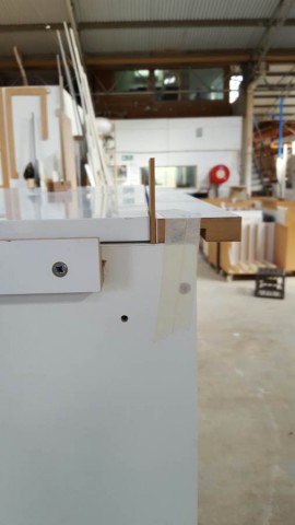

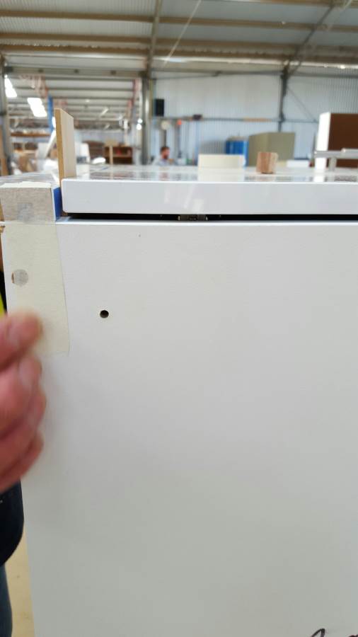

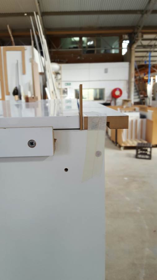

recently we have noticed when we do double doors the left hinge makes the door sit out 2mm away from carcus edge where as the right is flush. the pattern we have used for the hinge plate is the exact same as the right.
i measured the difference between the hinge holes on the right and left. the left was at 36mm and the right at 38mm. which is clearly where the 2mm is.
at first i believed it may have been because our y-axis was out or drill bank. but i noticed it had done the same thing on a 1992mm high double door cabinet. which can only be cut along the x-axis due to length
below is the left hinge door showing the gap:
below is the right hinge door as its meant to be like:
any ideas as to why it could be different increments?
hinge position difference by 2mm

. You might try checking the distance in the line drawing editor and if the distance is different there then it would be software related likely. Is it possible that your home position is not at zero on the Y axis?
Chris Armstrong
- Junior Member
- Posts: 69
- Joined: Tue, May 19 2015, 7:44PM
- Country: AUSTRALIA
Re: hinge position difference by 2mm
thats what originally thought. but if its out on the left hand end and not the right hand end it makes no sense. if the y-axis was out i should expect both the left and right end to be out. i have checked the program and holes are in the correct place. which means the machine must be out somewhere but i dont know where due to the rh end being perfectly fine and is cut on the same axis
