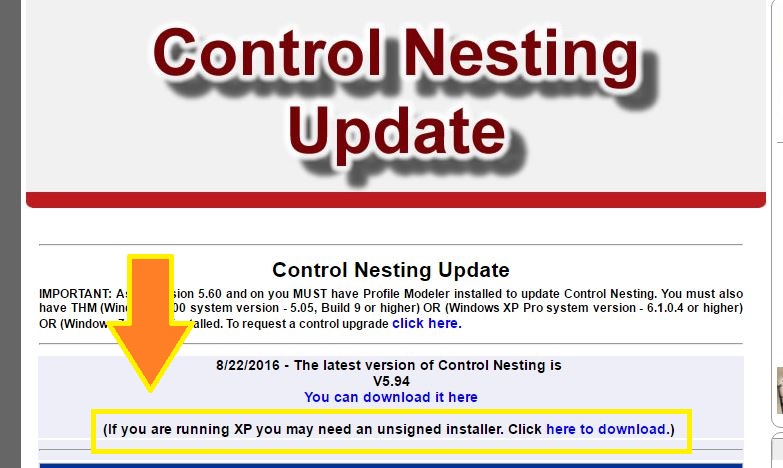

For those using a machine with Windows XP, we are beginning now to create two separate releases. One for those with XP, and one for those without. David has tried the XP version on his machine with success, but I would like feedback from others if they experience an issue with the install not working properly. Below is a screenshot for the location of the alternate install.
If you have an issue with the install, we will need a log file of the installation from you to aid in diagnosing the issue. If you are uncertain of how to create a log file, instructions can be found via Google, or email us here at Thermwood and we can assist you.
