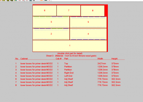

Post by Thomas strembitsky »
I nest a cabinet in ecabinets and random cuts are green just curious if any one has any insight

Thomas strembitsky wrote:I nest a cabinet in ecabinets and random cuts are green just curious if any one has any insight
Green means backside operations. Can you either post the cabinet or send it to cabinets@thermwood.com? Also what version of eCabinets are you using?

I'm using 6.1.3 and I'm attaching the esj

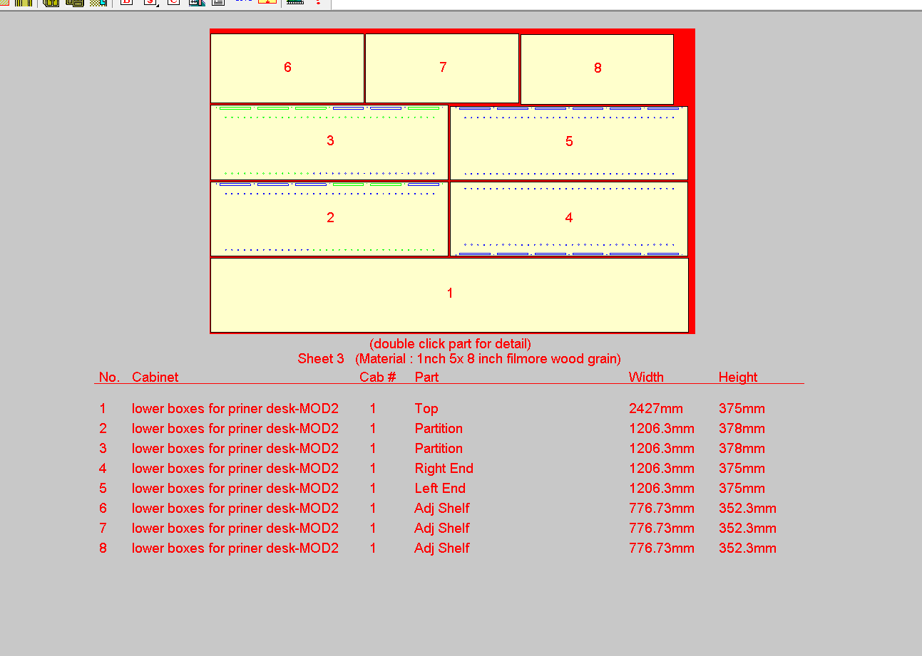

Post by Rick Deskins »
There is the same operations on the front and back of the partition. As Clint said, flip ops are green and front ops are blue. In this case since they front and back ops are on top of each other, it is random which one is shown in the nest.
