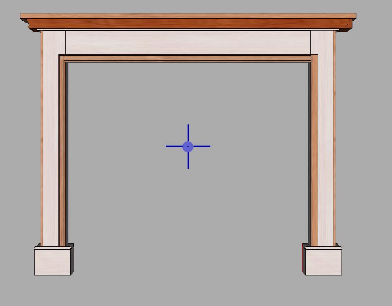

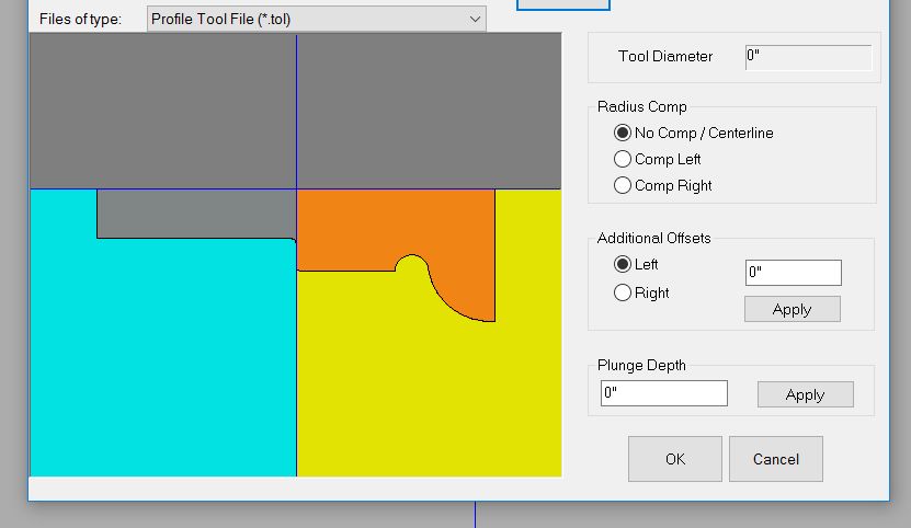

I'll post jpeg's of the cabinet and tool. I want to profile the piece on the right side of what would be a fireplace opening. The left side and top have been profiled.

Hi, Carman. Try taking the Part on the right into part editor. Then start the profile cut on the top left of the part. If that is not correct, Start the profile cut on the bottom left. It may take a few tries, or at least it does for me most of the time.

Scott, Thanks for the advice. Problem solved.
