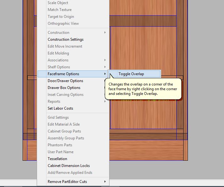

If I am reading your post correctly, go into Face Frame Editor, right click in bottom rail right next to where it meets the side stile. Hover over Face Frame Options, and choose Toggle Overlap.

See the attached pictures. In picture 11 right click on your cabinet where the red dot is. In picture 12 hover over Face Frame Options, then choose Toggle Overlap.
