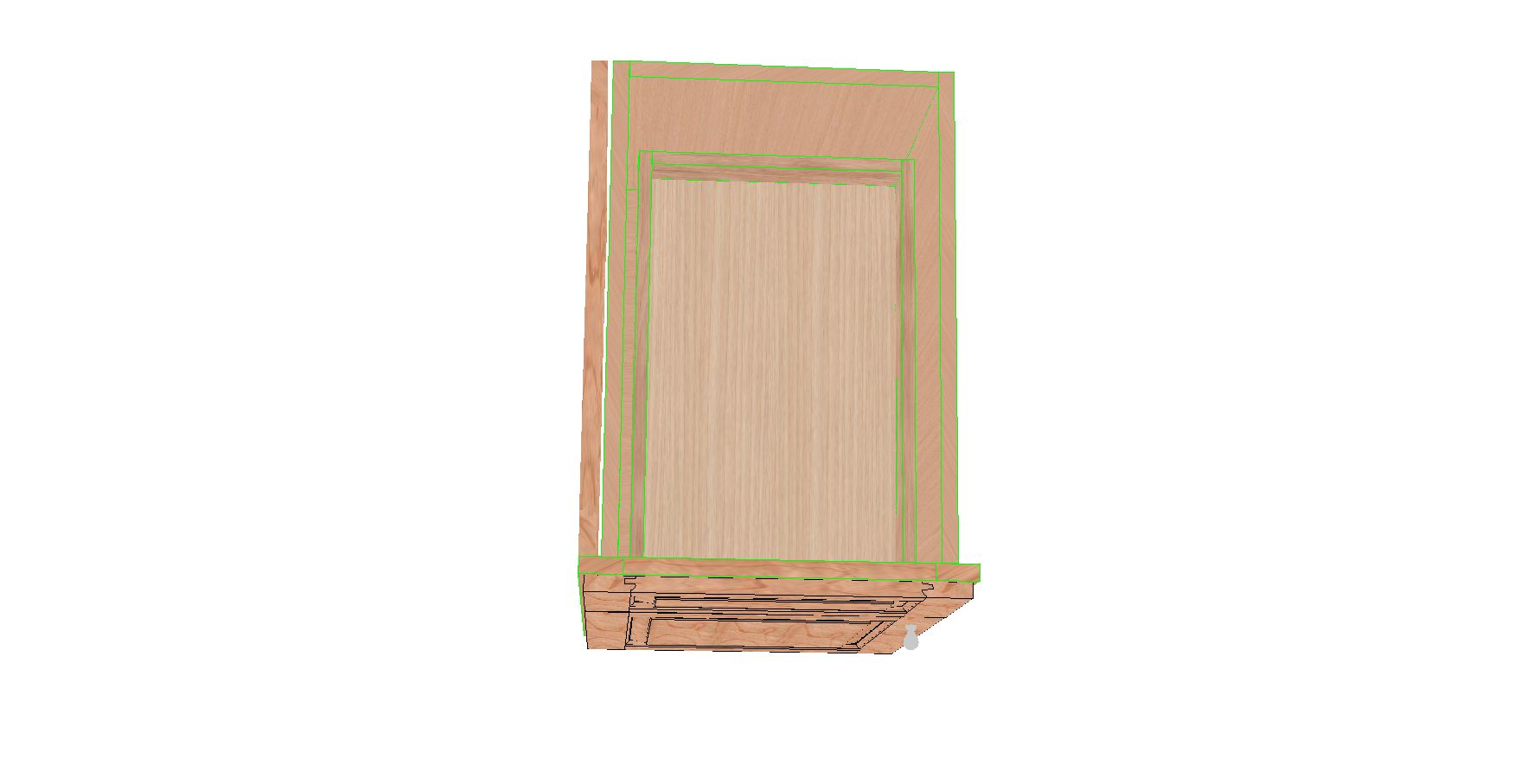

Are you creating a display door like this and then using the align function ?
This cabinet has a 1" scribe on both sides and I added a display door and aligned it to the scribe on the left.

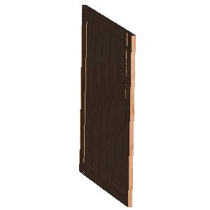

Ok I brought a base cabinet into the editor selected Doors/Drawers on the right side menu, added a Conestoga CRP10 door sized 24w by 29.5H (I have a 5" toe) aligned the door to the right side, unchecked all cabinet parts. That left just the door on the right side. Saved cabinet, created a room added another cabinet then added just the door cabinet adjusted spacing between cabinets as it did not want to space correctly.
The door shows up in the cut list like it should, you should not have to resize it as it is just an end panel and you should only need a base and different height wall panels I think.
I used global adjust features and changed the doors and it will not change but it does show in the cut list so it seems that would take care of all except changing doors.
You wont need to make this an assembly as you can take the Door Only Cabinet directly in the room, and resizing wont be necessary as it is a cabinet by itself.
Here is my Rt End panel only cabinet, I hope this helps
Tim

Tim Thanks. That was a big help! Always thought "add end panel" was my only option of adding a door as an end panel.
