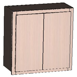

Here is a slab door cabinet that will nest with the cabinet parts - all 3/4 plywood
Std Upper Framed.jpg (13.93 KiB) Viewed 19228 times
Std Upper Framed.hsf
(290.02 KiB) Downloaded 1744 times
