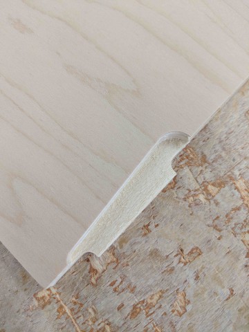

Hi guys, I have a little problem with blind dadoes when I have to do a flip operation on a part. The tongue is cut on the first side of the sheet and then when I flip the part to cut the thickness off of the tongue it cuts a big gouge into the part at an angle. I will attach a picture so you can see what I mean.
Is there something I don't have something set up correctly or is it something else?

Ralph Balanik wrote:Really hard to know where to begin until more info is provided. What machine are you using? How are you setup? what kind of hold down system do you have? Are you doing flip ops first or last? Maybe a picture of the machine. Are you using different tooling for different operations?
Ok, I'm back...
1. I am using a model 45
2. I cut the parts out of the full sheet and then flip the double sided parts at the end using a 902 offset and a square
3. I have a vacuum hold down, or in the case of small parts a vacuum and double faced tape hold down
4. I am using a 3/8" down cut end mill for the blind dado operations. Since, I'm in 3/4 plywood that means that I am doing the blind dado tongue with one pass.
I don't think it's the ramp in settings because it does it after it cuts the tongue. It almost seems like the cutter compensation turns off before the tool lifts out of the wood. But I don't know why it would go back to it's starting point then?

It wrote an odd line of code in there. Can you load the file into Control Nesting and then get me an export? Once its loaded go to File and then choose Export. Save it somewhere you can find it. If you can post it, that would be great, if you can't, you can upload it here http://www.ecabinetsystems.com/eCabinet ... FileUpload. If you have to upload it, let me know when you do.

Something is going on with the Single Pass Tenon Cuts being checked. I'll have to send it to the software engineers to have a look at. Looks like unchecking that setting lets it work correctly, just a bit more machining time to cuts the tenons.
