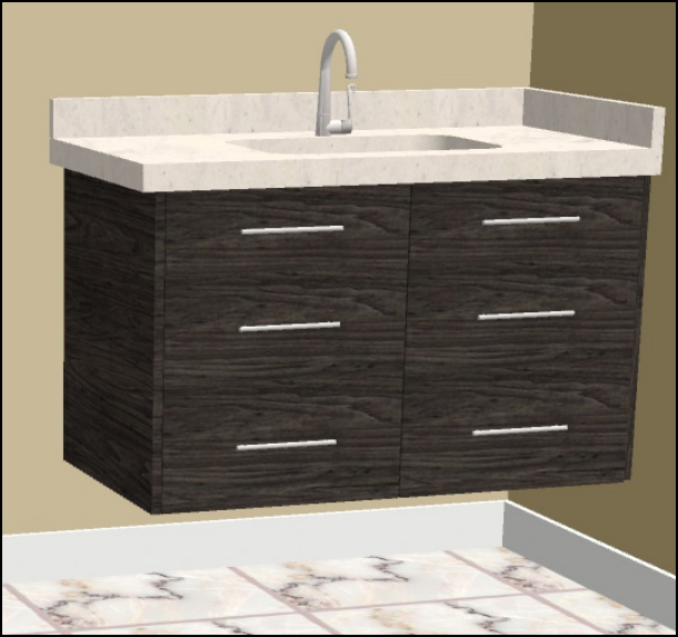

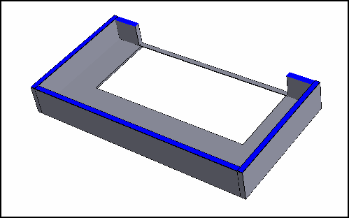

I need to build a vanity sink base that looks like it has 6 drawers, but the two top drawers are actually one and will open together as one with a U-shaped cutout for the plumbing.

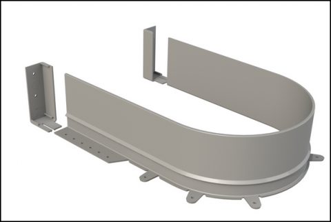

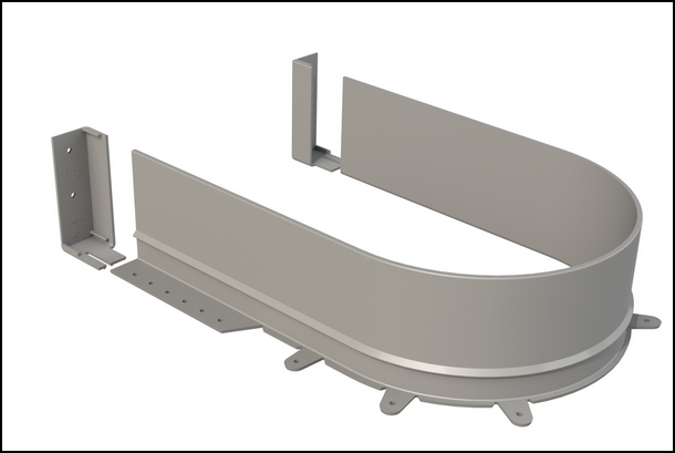

I'm hoping to use this flexible plastic trim thingy to finish off the cutout and allow me to create the drawer box in Ecabs so I can cut the bottom on the CNC with the rest of the cab parts.

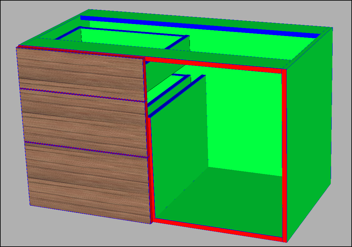

1st Problem: Drawers in Cabinet
When I build the cab with a partition to mount the drawer slides on for the two lower drawers, it won't let me add a single drawer above it.
And if I build the cab with a vertical stretcher instead of a partition, it won't let me add two drawers side by side.

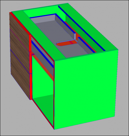

2nd Problem: Drawerbox Cutout
I can't figure out how to make the dbx with a round fronted cutout in the bottom and two separate back pieces. This is as far as I could get, but it's obviously not what I need.

Darren install a shelf first at the desired height for the first drawer then install your partition below that. You can make the shelf a phantom part or just give it a back inset so that it is narrow enough to clear the sink. This will also help hold the partition at it's front edge at the proper location.
Install the lower drawers as normal. Then go to the DBX editor tab and install a single drawer for the top drawer. Then go to the main editor tab and install two display drawer fronts.
For the curved cutout this needs to be done in the part editor in the "Contour area". To give a quick example for a 10" wide cutout connected by an arch.
First right click --> create edges. Then draw two lines 5" from center of drawer bottom. Add a circle with a 5" radius at desired location. Trim the intersecting lines so you are only left with the desired cutout shape. Go back and get out of countour mode. Right click --->Cut pocket using closed counter --> click on cutout ---> Cut through.
I don't know how familiar you are with part editor and aligning display parts like the display drawer fronts but the above will get the job done for you if I understood your situation correctly.

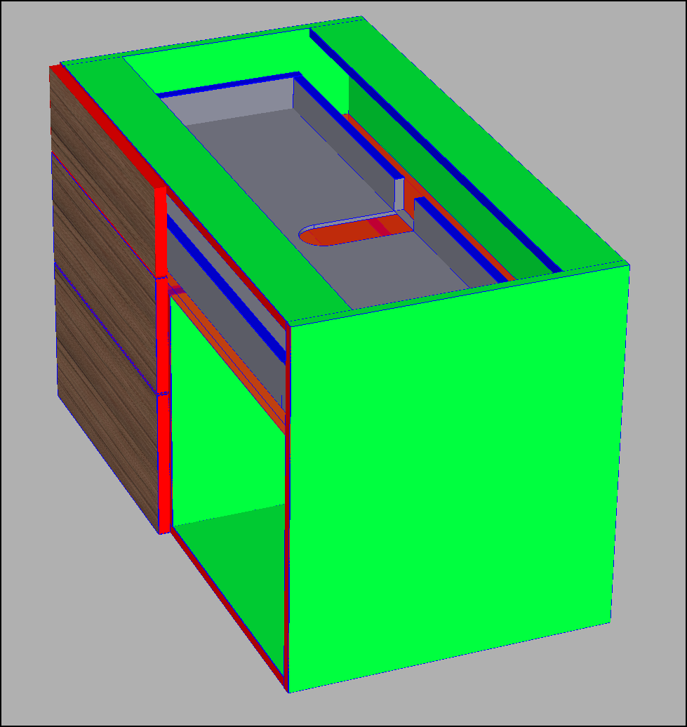

Brilliant Carmen! It never ceases to amaze me at the ways people find to make software do WTF we need it to. As with most things Ecabs, working in Contour mode is about as intuitive as teaching my dog to fly a plane. But thanks to you I was able to get the bottom cutout as required, and can even reposition and resize it easily now with constraints. Your suggestion to use a fixed shelf with display drawer fronts worked perfectly also. Here's what the cab looks like w/o the right-hand set of drawers.

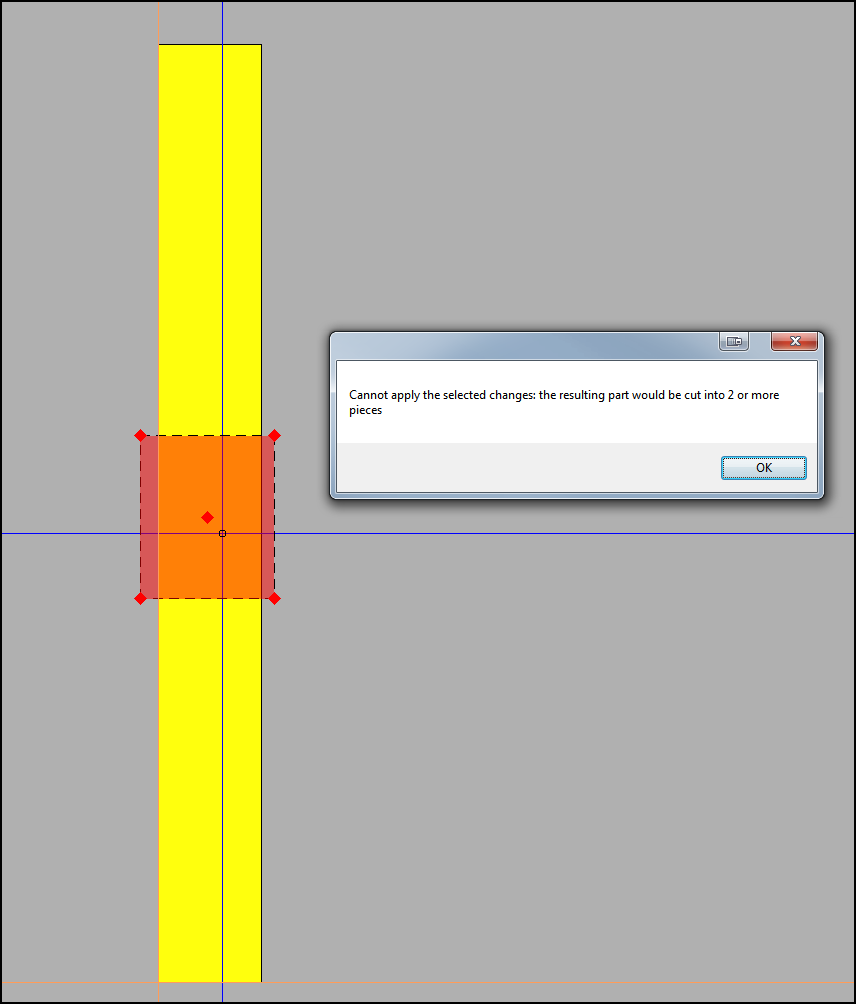

You might notice I couldn't figure out how to cut the back into two pieces (there's a little bit of it stiill connecting the two halves), but it will surely get me through this job.

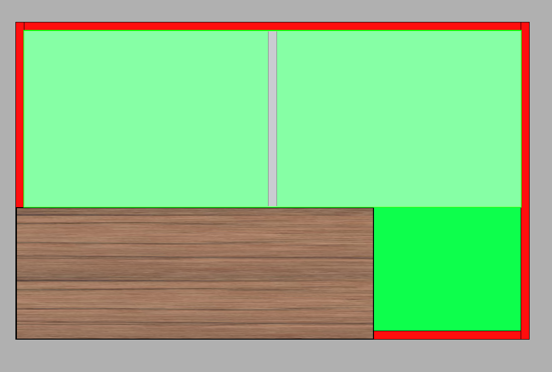

A Note About Display Fronts
Post by Daren LaBranche »

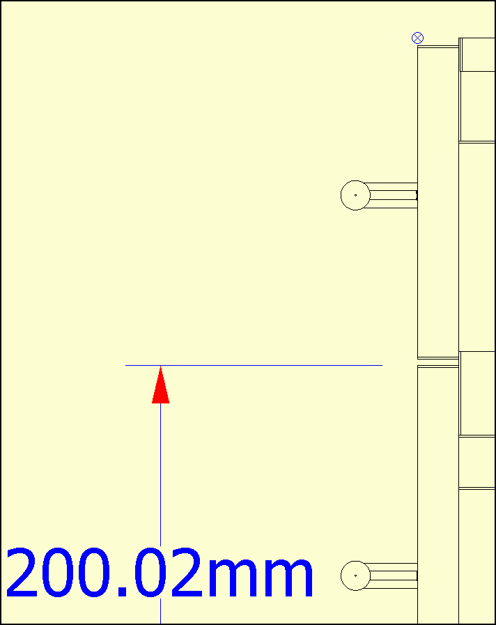

Unless I'm missing something, I can't select the display fronts on this cab in the LDE, so I can't check their dimensions or fit with other parts. You can see that the lower drawer front that was installed as a regular drawer is selectable and I added a dimension to it, but the top drawer front isn't and the marker won't snap to it (closest snap point shown).
Display front unselectable.png (6.1 KiB) Viewed 30208 times

Are those display drawer fronts display panels or drawer fronts without drawer boxes?
Dave Egnoski

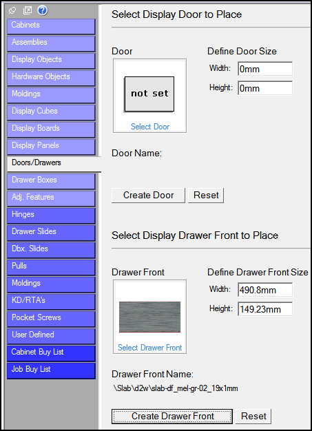

Display drawer fronts David. Here's where/how I added them.
