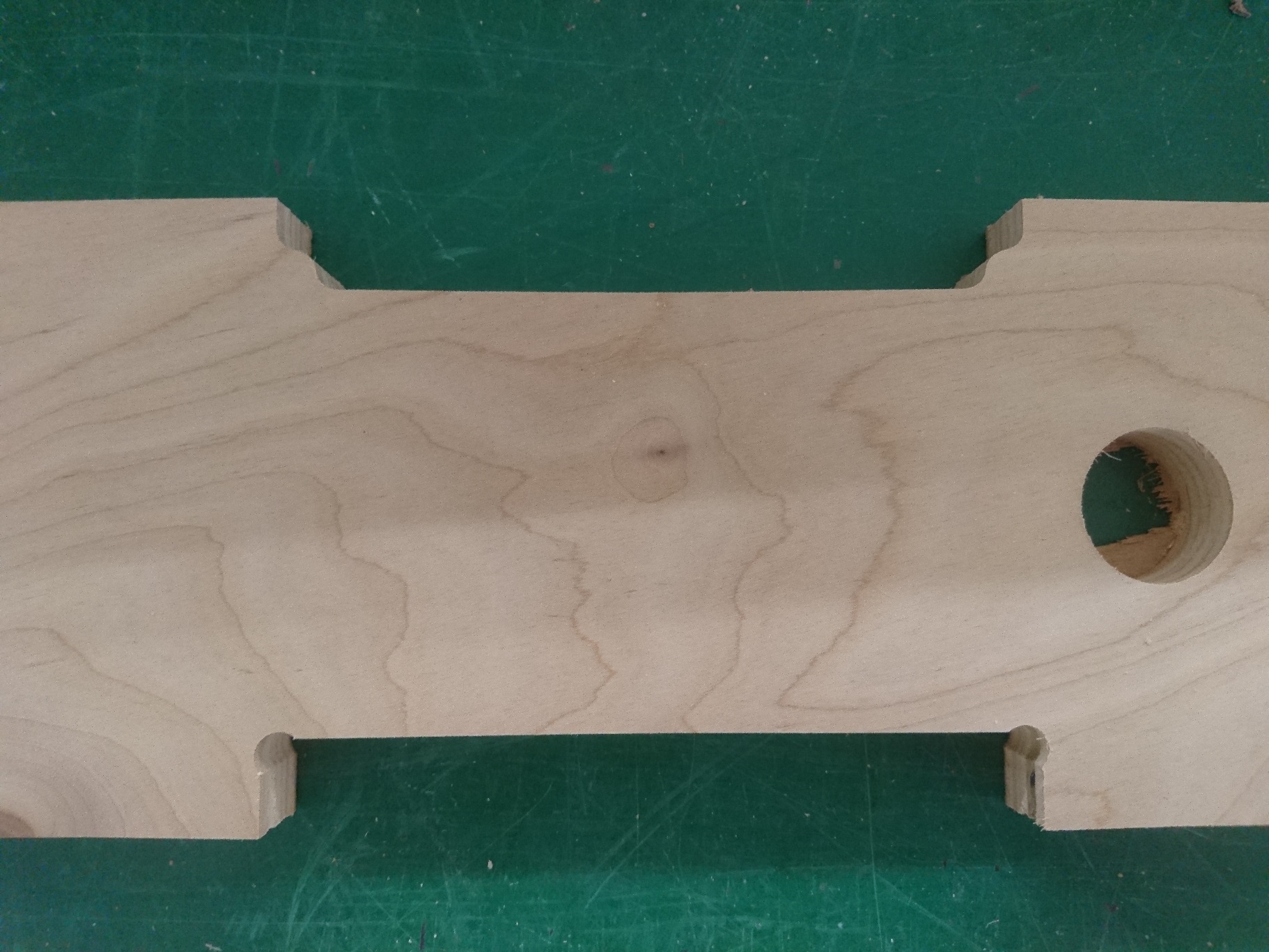

- Posts: 176
Re: DXF pocket behavior
I got my holes cut using the method mentioned in the above posts using the DRILL command and subsequent parameter tree, but it looks like the DXF arc bug is pervasive. One side of the stud has proper dogbone corners, but the other side cut them "inside out"? See attached.

- Larry Epplin
- Posts: 668
- Location: Thermwood
Version 6.13 should resolve these issues. It is now available.
