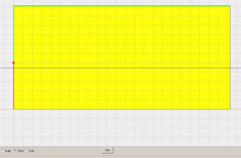

Has anyone else experienced a glitch when you select Partial in the profile edge window and select 1 edge okay but when selecting a second edge it selects all 4 edges like a Chain. Seems like I used to be able to profile 3 edges for my tops.

I haven't experienced this issue but you could take the piece into contour area, Create edges and then delete the edge(s) you desire. Back to part editor and run the edge profile.

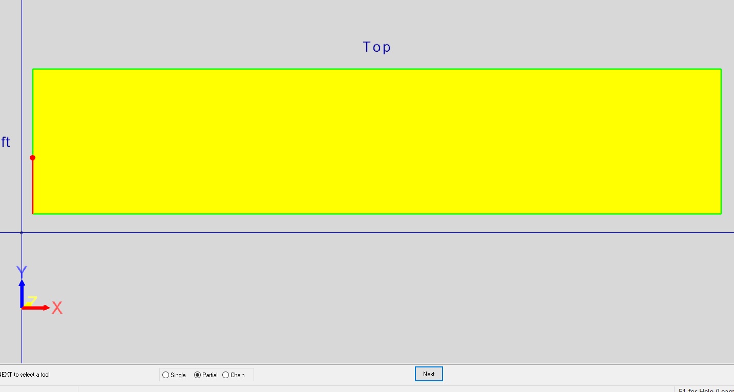

in my test if I click on the bottom next all sides are selected, if I click the top next just the left and top are selected
so it looks like the profile is working correctly. Hope this helps

Just testing and yes I experience a similar thing.
In the attached piece it has pockets
I can select the bottom edge
click the left hand edge and it selects 3 more edges or says there was a para solid error creating a new part body.
If I remove part editor parts from entire cabinet in the cabinet editor and try again in the part editor I select the bottom edge can only select either the left hand or right hand side and the selection stops.
