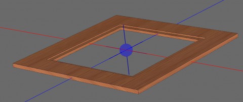

How can you make, a one piece, mdf or slab door, open for glass? short of going into the part editor and drawing each door.

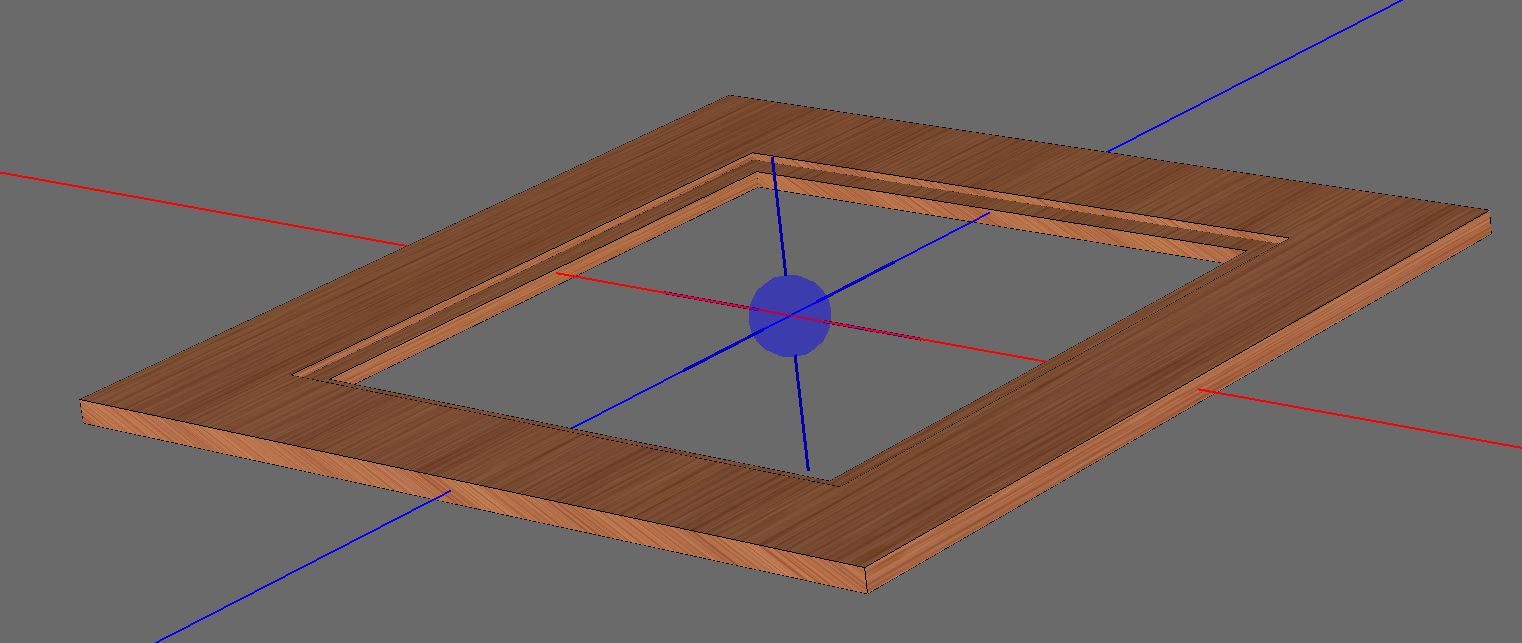

Use a cabinet part (the back is convenient), make your part editor cuts in it - two rectangles, one inside the other - cut the inner rectangle thru, and the outer rectangle 1/4" deep or so. Then take it to the constraint manager and constrain it to the dimensions you need. Save it, and use it as a seed.

Unfortunately Will it can't be done until they give us the option to make part edits on doors and save them off to a library so they can be applied on a global level. Been asking for that for well over 10 years. What I've been doing is taking my door list and create a batch file in the same job using the modified cabinet back such as Jeremy posted. Total pain in the butt and mistakes can happen but it's the only workaround we have.
