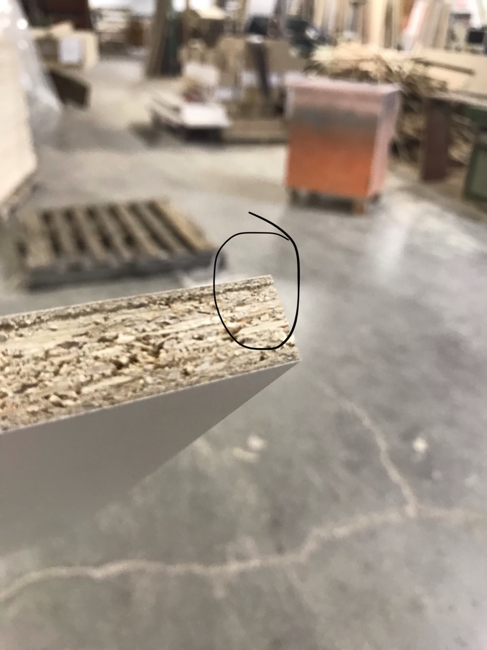

Any idea what cause this when I go 2 passes ?

Bit or machine deflection. If you do your initial pass as a climb cut, and final pass as conventional cut, it won't leave that lip.
