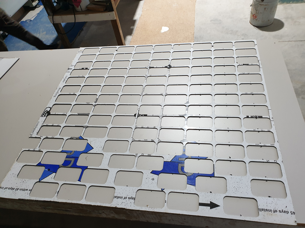

In the attached photo we cut 120 of these at a time, (The pieces we use are removed and this is the waste)
Control nesting seems to get to about 100 pieces and then says this is all too hard, I'll just stickem where I can.
The yield goes down a little bit once the grid like nesting drops off.
Does this happen to anyone else when nesting large quantities on one sheet?
(The parts all nested fine, I used a leftover offall, thats why one is off sheet, Its just the nesting pattern is a bit random towards the end.)

Mark,
For parts like this, I would try to change the setting under Action from True Shape, to Cut Line. I'm going to guess that will get it nesting better.

Thanks Clint.
I will look into that. :D
