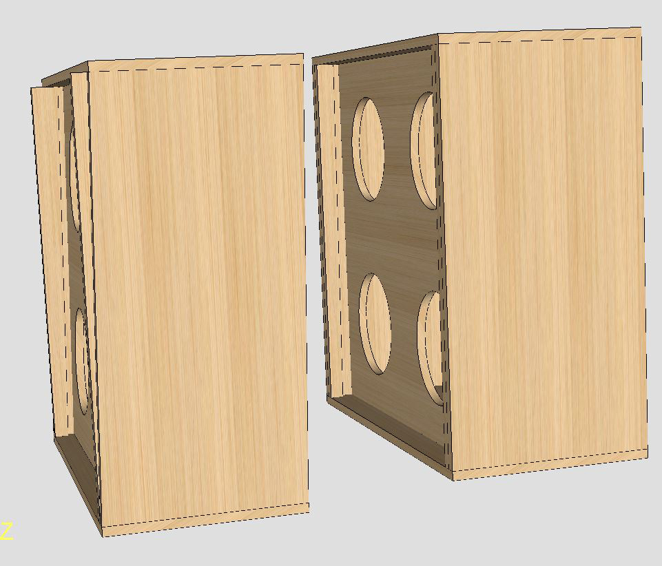

Obviously a speaker cabinet. We have been making these for awhile but they want us to make the front with a 2 degree angle and the back parallel to it. Have added a stretcher with taper but cannot get the speaker or back to leave vertical.
Thanks for the help.

Re: Angle part
Hi Rob.
My take.
I couldn't see the angle or really understand what you were referring to until I had been messing with an idea and eventually saw the angled front frame in your cabinet.
So I had been messing with what I thought you meant.
Perhaps it might be useful?

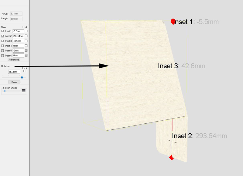

I deleted the back and made the back a stretcher.
There is a rotation control in the stretcher editor.
I had angled the ends by drawing outlines and using the create part from closed contour in the part editor. (Actually I imported the DXFs because I used another program that I find easier to use than the drawing program behind the part editor) but it can be done in there.
And then I saw your angles
I attached the cabinet even though it is wrong just because it may help you, not sure
