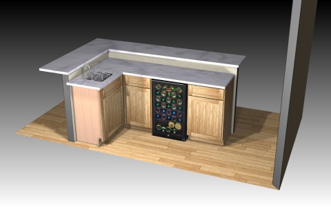

Can anyone give me an idea how to make L bartop similar to the attached without the sink cutout and backsplash? Tried making the cabinets / adding top/ delete the cabinets, didn't work.

try making it from a cabinet top. Make your cutout to form the "L" and then set your constraints. Resize and see if it works. Increasing the width of cabinet will size one leg and cabinet depth will size the second leg.

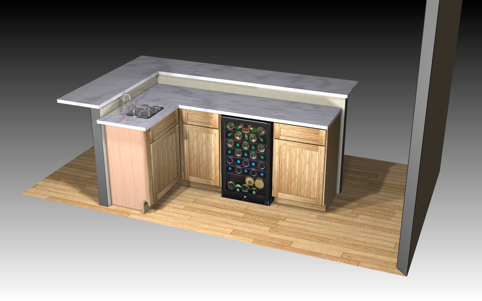

Thanks Carmen, I ended up taking a pie cut susan and adjusted the size I needed then deleted everything except the full flush top which I made a phantom part. Now I can resize to fit the sizes I need and add the countertop.
