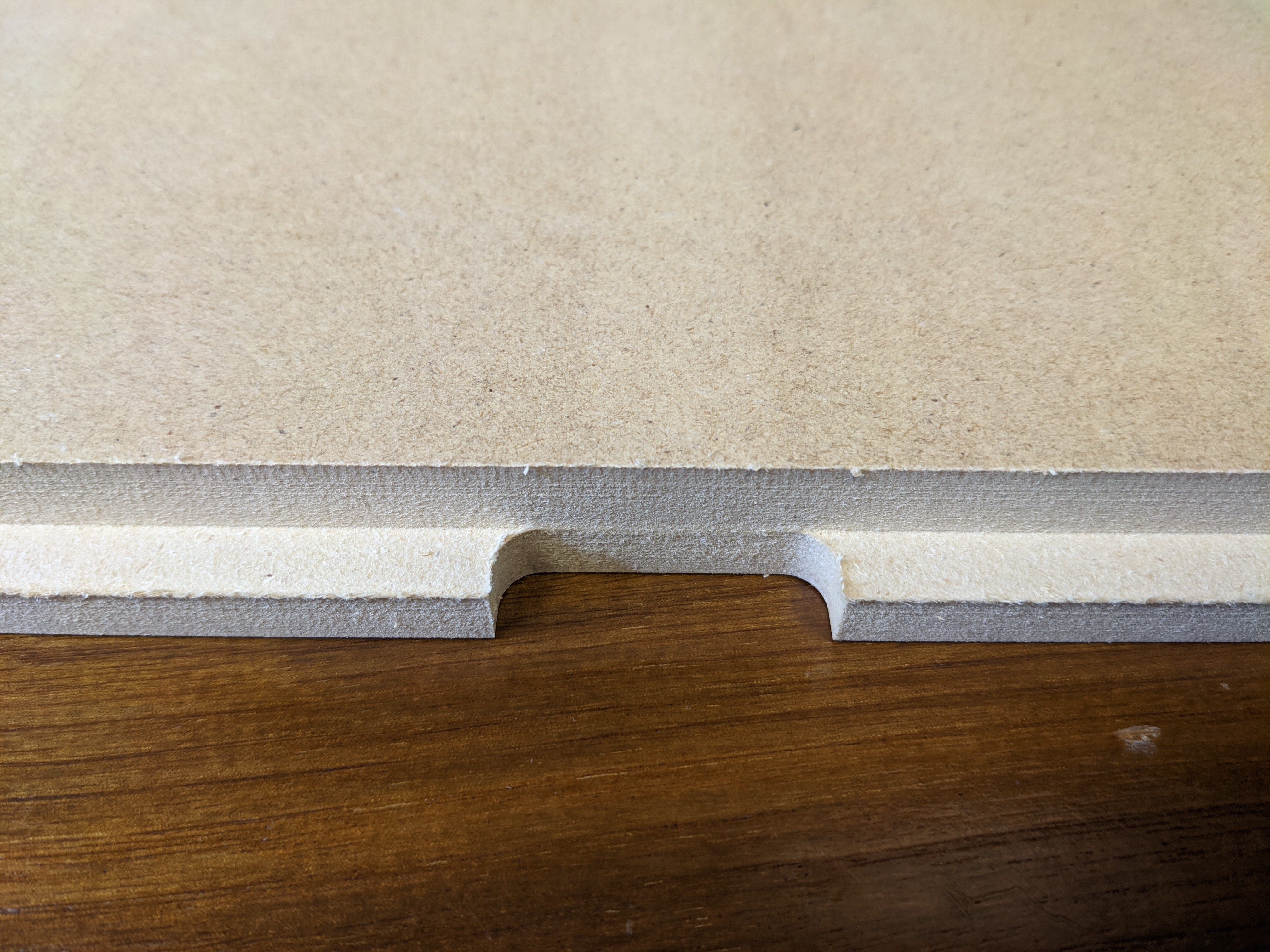

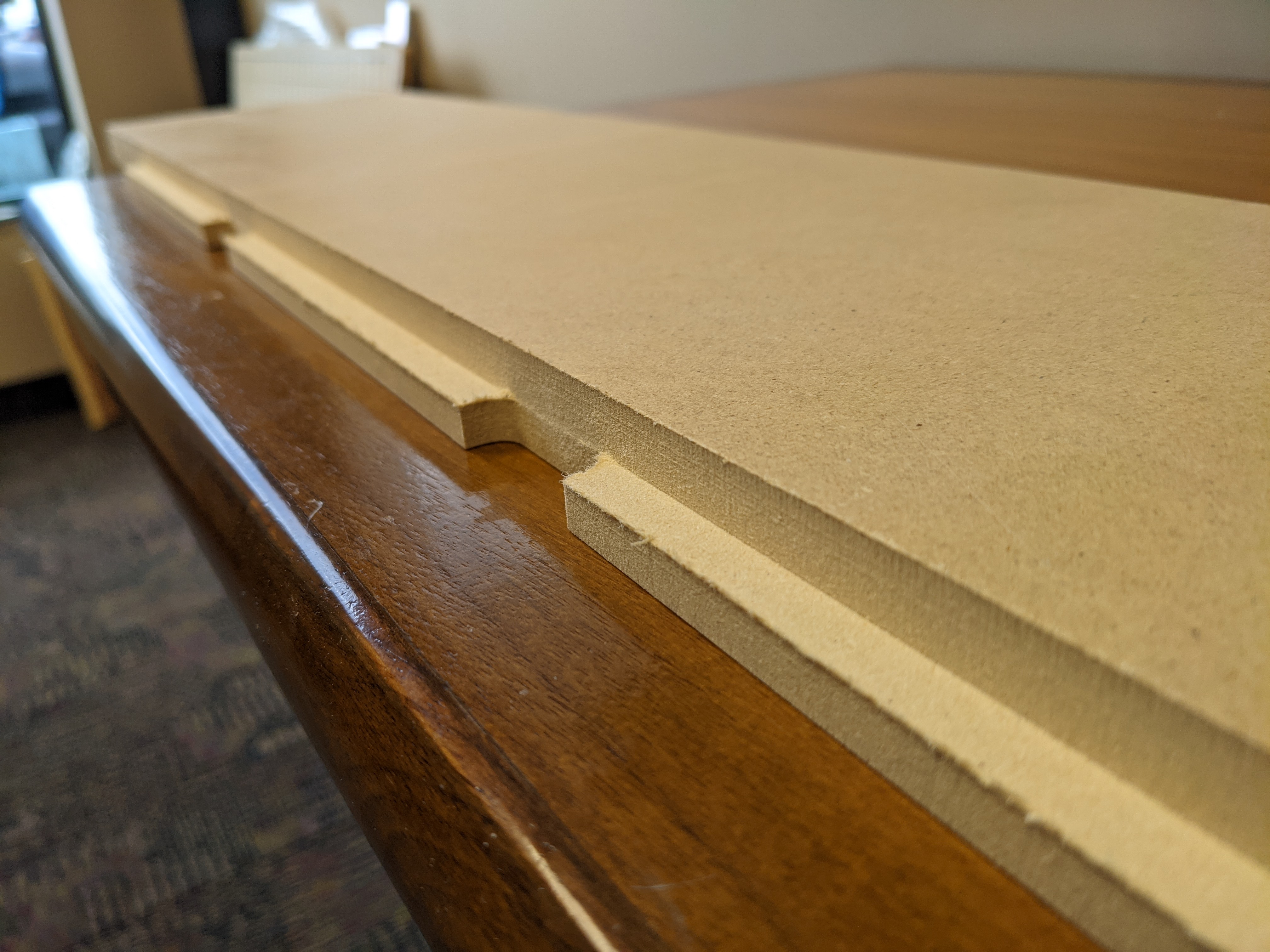

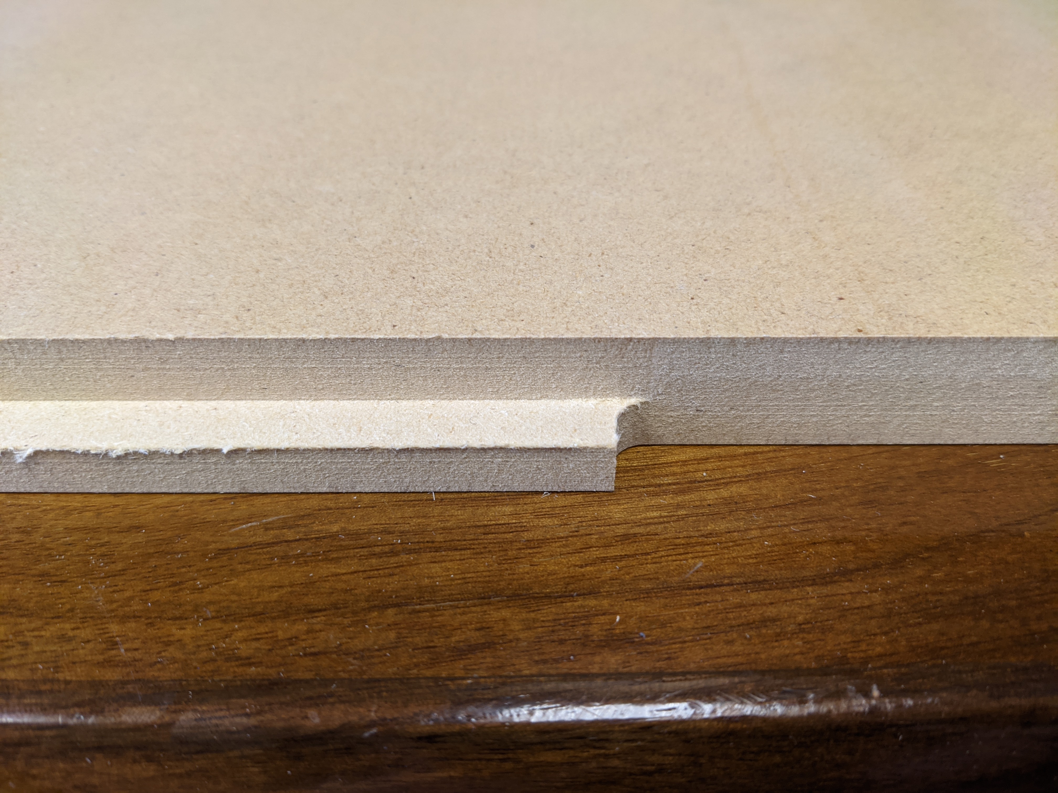

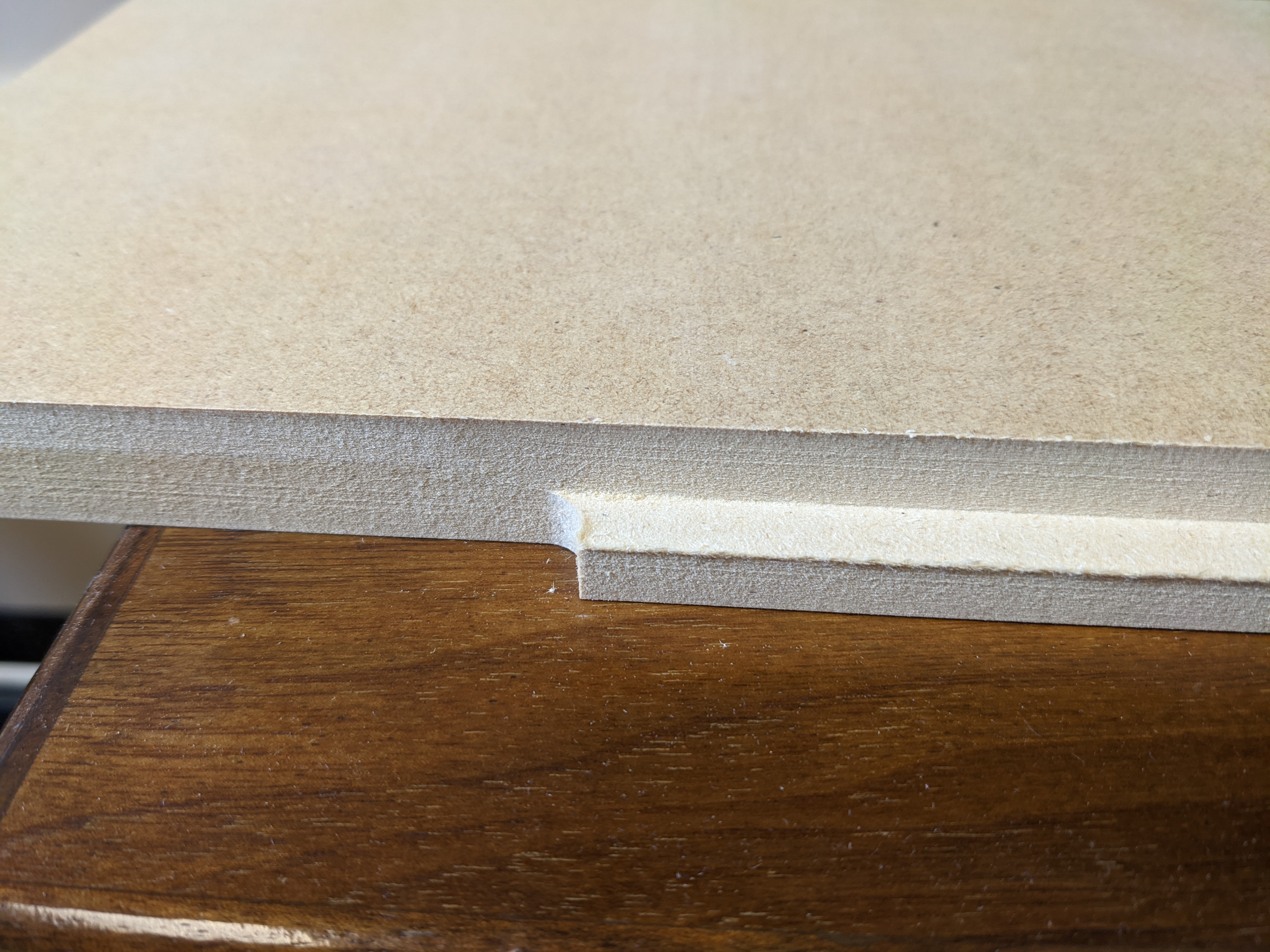

Attached are pictures when I run your code for the part in your original picture. Picture 1 is the entrance, 2 is the gap between tenons, 3 the exit, and 4 is a shot down the edge. There is a lip I can barely catch my fingernail on, nothing near as bad as what you are seeing. It was cut on our demo Cut Center, it should be results similar to what you'd see on your 45. On the 41, its a tossup due to its age and what may be worn. I did run the same feeds and speeds, though the Cut Center would have faster accelerations than what either of your machines would be, but if anything that would make it worse.
There is a slight bit of fuzz on the outside of the tenon, though I'd say that issue is due to the outline tool having a 3/8" upspiral in the compression bit and it being MDF.
That all being said, for giggles sake try bumping up the diameter of your tool. With me running the code, the only differences will be tool diameter accuracy, type of tool, how good of shape the collet is in, or possible machine mechanical issues. The tool I used was measured off the high tolerance tool sensor that can measure diameter, so the diameter should be accurate. The tool is our standard Cut Ready 3/8 compression. Not sure on the amount of use the collet has, though I know it is not brand new. We don't see any issues in our cutting so I'd assume the machine is in good mechanical standards.

Thanks for checking that for me, Clint. What you have looks exactly like what we get from our 45. There is a ridge there, and on the assembled parts it leaves a small visible gap. If we could have the Single-Pass Tenon cut do a climb then conventional cut, that ridge (and resultant gap) would be totally non-existent. I don't know how difficult that would be to add to CN, but it sure would make me happy.

The pictures make it look worse than what it is. When I say I can barely catch my fingernail, its me having to put effort into trying to get my fingernail to catch. You may still try upping your diameter a little and see if that clears it up. Looking at my part in hand I wouldn't see there being a gap when it goes together, though I haven't cut a mating part to try.
