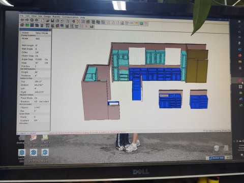

Here's what happens when I restore eCabs from a minimized state. As you can see, the eCabs window is shorter then the screen is tall. If I click the Restore Down button, then the maximize button, it will fill the screen. It's been happening since the last major upgrade of eCabs. Prior to that upgrade, it would minimize and restore like it's supposed to.
Brad, since it's working on your system it must be some setting I have on my machine that the previous version didn't care about but the new version does care about.
eCabs is the ONLY app on my system that doesn't minimize and restore properly. All other apps I use behave as expected.
