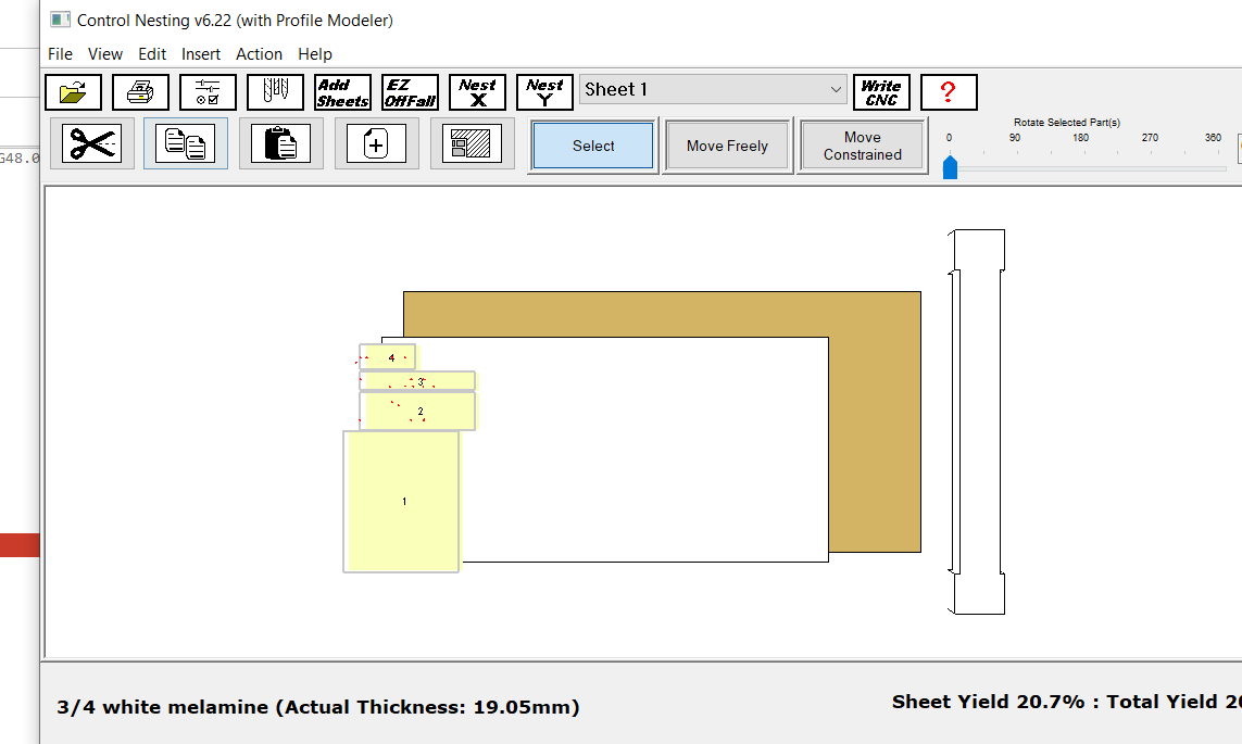

steps: load a job and nest it. using the manual nest toolbar click select, select a piece and then click move freely, move the piece and then every piece will move off the sheet. please see attached picture. this is useful feature please fix
Edit: no issue in version 6.20

Thank you, we have seen the issue as well. It has been there for a little while before that just not nearly as bad. It does still work, it's just the view is becoming tilted. You can press the Home key on the keyboard and the view will reset back.

thanks for the work around
