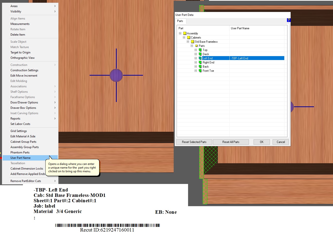

You can use User Part Name to include the part name and an annotation. See attached image.
