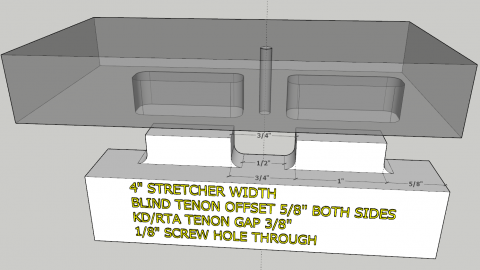

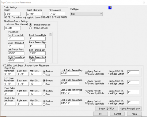

Thanks for that info, but if you've the time, take a look at this pic, attached.
I am trying to arrive at a good standard for my seed builds, and what is displayed is the result of me specifying for 4" stretchers and back-edge tops in base cabinets with drawers, a lock dado joint with these settings
3/4" thickness material
3/8 depth tenon cut (50 percent of material)
3/8 depth mortise cut plus .030 fit extra depth
1/100 dado fit extra
Blind dado inset 5/8" L and R edges (or front and back if oriented such)
KD/RTA gap between tenons 3/8"
1/8" dia. pilot hole for screw (done with pattern)
I did the 3D model assuming a 1/4" diameter bit is used to cut the tenons (the thru cut) and the mortises (dados).
The tenon width of 1" is from a careful examination of part geometry using the part editor.
The mystery here is the gap between, specified as 3/8, but actually 3/4". Or measured across the flat between machined tenons, it is 1/2".
So where is the 3/8". Try it yourself, measure, and explain to me what the 3/8" setting does.
I included a screencap of the construction settings for this part, a 4" top set flush to back.
Gene Davis
Posts: 62
Joined: Sat, Sep 02 2017, 7:30PM
Company Name: Gene Davis Builder
Re: Diameter of bit cutting typical tenon joints?
Post by Gene Davis »
I think it may be that eCabs code takes that KD/RTA tenon gap value input by the user, doubles it, and makes the result the gap between tenon tips. This has to be it.
Unless someone has another explanation.

I played with the settings some more and examined results with different inputs.
What is called the LOCK DADO TENON GAP is more accurately described as TENON OFFSET FROM CENTER OF KD/RTA FASTENER. Thus, twice (2x) the value inputted is the tip-to-tip tenon gap. It is a gap thus measured no matter what diameter cutting tool creates the parts.

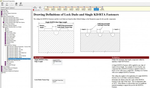

Gene,
The help manual tells you what the Lock Dado Tenon Gap refers to.
