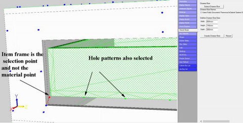

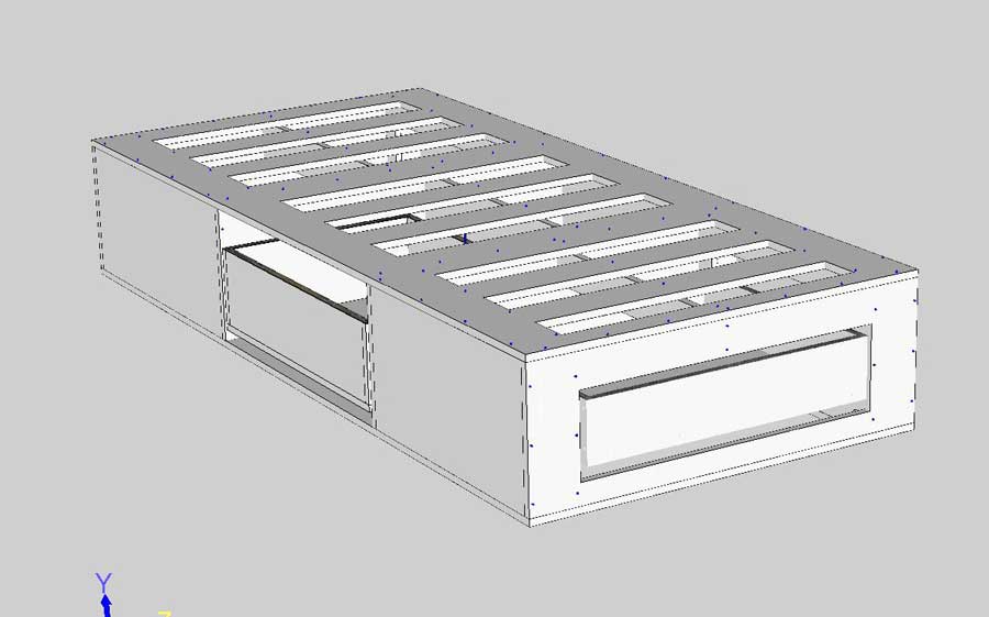

I am doing a file for a adjustable size bed frame and am adding drawers ect-cetera.

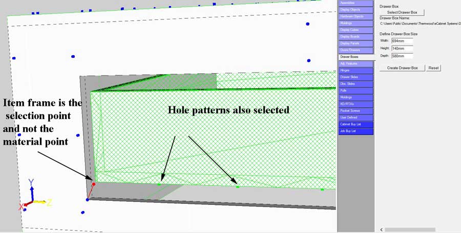

Just trying to Align and place the drawer box accurately but the object frame including the hole patterns is included unlike the main cabinet.
The project

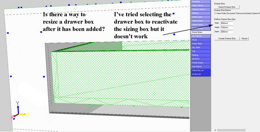

Would it be possible to select the drawer box and resize it without re entering and adding, rotating and relocating the box?

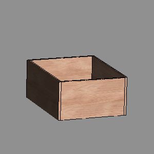

Is that an assembly? If so, could you use something like this (see attachment) it is a cabinet that is only a back (phantom part) with a drawer box attached. This lets you change drawer boxes and size.
Drawer Box.jpg (6.7 KiB) Viewed 5190 times
Drawer Box.hsf
(402.02 KiB) Downloaded 408 times
