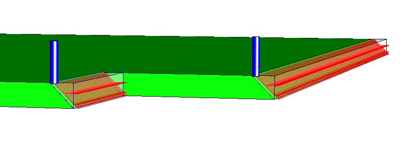

The part is an end panel with a toekick cut in it, and we are mitering the front edge of the end panel and the toekick cutout. The front edge of the end panel does perfectly, but the toekick miter has several oddities:
As you can see, for some reason the toekick portion gets cut way deeper than the part thickness - I did cut it, and it did go into the wasteboard by that amount.
Also, it cut into the face of the toekick miter, you can see the toolpath is buried in it.

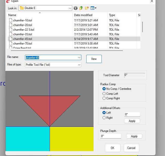

Can you post or email me the .tol for your original tool, your plunge depth, and the cabinet you are working with? I don't get the same results as you working with the below pictured tool on the Std Base Frameless cabinet with toe kick notch. I plunged mine at -.75", the thickness of 3/4 Generic. Picture from Profile Modeler in Control Nesting is using your export with the material added to Group 1.
Re: Profile modeler inconsistent toolpath
Jeremy,
Make sure your chamfer tool in eCabinets is symmetrical, and that you have it cutting on the line, No comps or offsets. Plunge it the depth of your material. You also won't need to do the toe cut in the part editor.

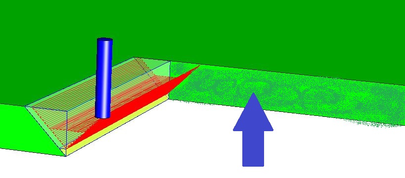

I tried a tool similar to yours, but it did profiling for the entire tool in the toe kick notch area. I suspect this is because it was seeing the top of the notch area as having material the profile was "touching" so it created the path for the entire tool. Jeremy is on latest version of Control Nesting, and I assume looking at this in the Configure Specific Regions section of Control Nesting. If it is being looked it in specifically Profile Modeler (such as what it looks like in your screen grab), that is another story as it runs slightly different code than what Control Nesting does. With release of version 7, you can now view your profiles in Control Nesting as well as make tool group selections based off material groups.

We are using Control Nesting 7.2 and this is the view of the profile modeler from inside Control Nesting

Might be my eyes, but I think I see red lines like it is profiling open space around the part? You should be able to see for sure if you rotate around and zoom in. If the red lines are there in the screen the motions will be in the code for them.

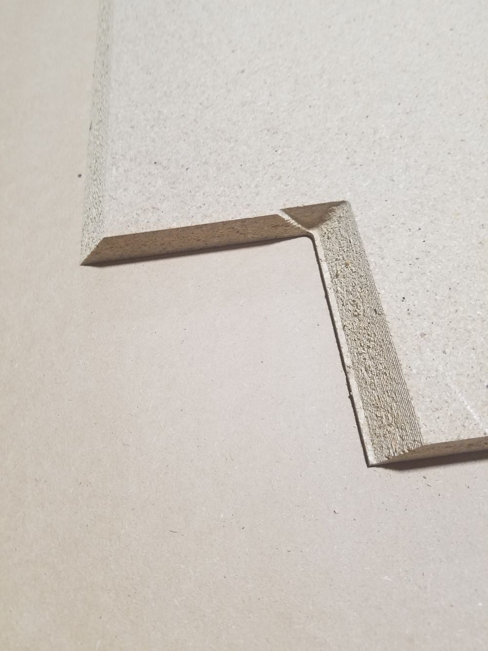

Here is a shot of what I got after cutting.
My cut on the toe was shallow about 1/8" and it cut into the top of the part the same amount which is half the diameter of the tool I used.
It also cut the back side of the tool as you guessed.

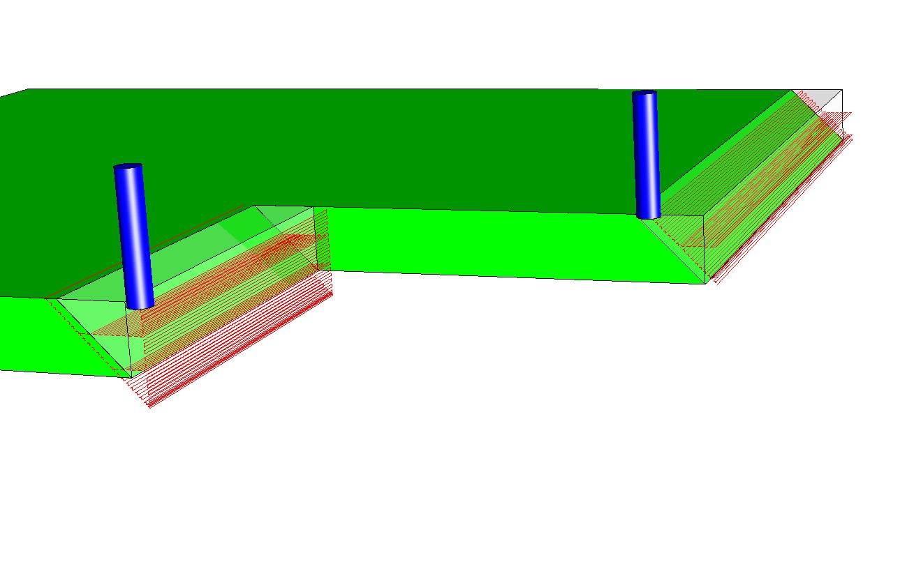

Clint, we've got it working now, using an asymmetrical tool such as you have drawn. It is possible to change the material thinner, and it will still work. But making the material thicker will create problems.
Using a symmetrical tool gets exactly what Kerry has shown - which is what you'd expect given the tool won't fit into the bottom of the V. It's more of a mystery as to why the asymmetrical tool works, because it is sharp on the bottom as well, but the tool DOES go all the way into the point.

In my speculation (software engineer I need to ask is in Europe), it is because with the toe kick, the profile tool is touching the shaded area in picture 2. Not removing anything, but the tool is riding along that surface so it is picked up as an area the tool is contacting. In picture 1, I used Contour Mode to create geometry for the tool to sweep on, .060" away from the top of the toe kick, and swept along it. Same tool, same depth.
