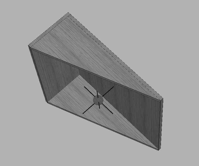

Something like this?

Almost. The back corner is acute, not square. The left gable of this cabinet is normal, but the back comes to the front corner of what would normally be a right gable. This is supposed to be an open euro-style box, nothing fancy except the angle. I can make what you've shown, but can't figure out how to make the back corner anything but 90.

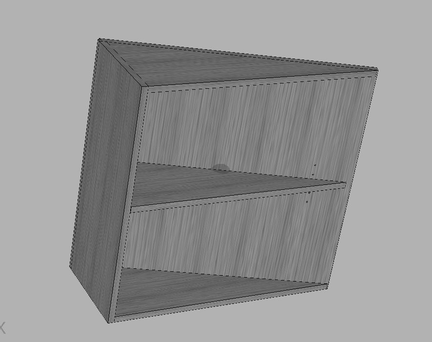

More like this?
Stuart Douglas
Posts: 177
Re: Corner cabinet with acute angled back
Post by Stuart Douglas »
Like that Kerry, but with the front face square to the side, not the back. I think we are on the right track, I might have to build this cabinet backwards it seems.

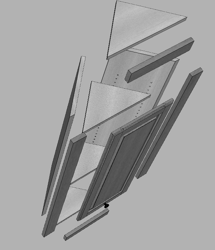

One more time.
Stuart Douglas
Posts: 177
That's it, Kerry!
Now how did you get there? :) Did you trick yourself by making the back into the front?
_____________
NVME SSM2HD 1TB NTFS
The back on this cabinet is a stretcher. You have to go back to the stretcher editor and play with it every time you re-size width.
I still have the back as a phantom part to get the adjustable shelf hole pattern to use on the stretcher.
I think a better way to do this might be to forget the stretcher and just take the angled top into the line drawing editor and measure the length you need for the back and simply use back left right insets to size it. It just won't display as an angled cabinet.
I have attached the cabinet if you want to look at it.
